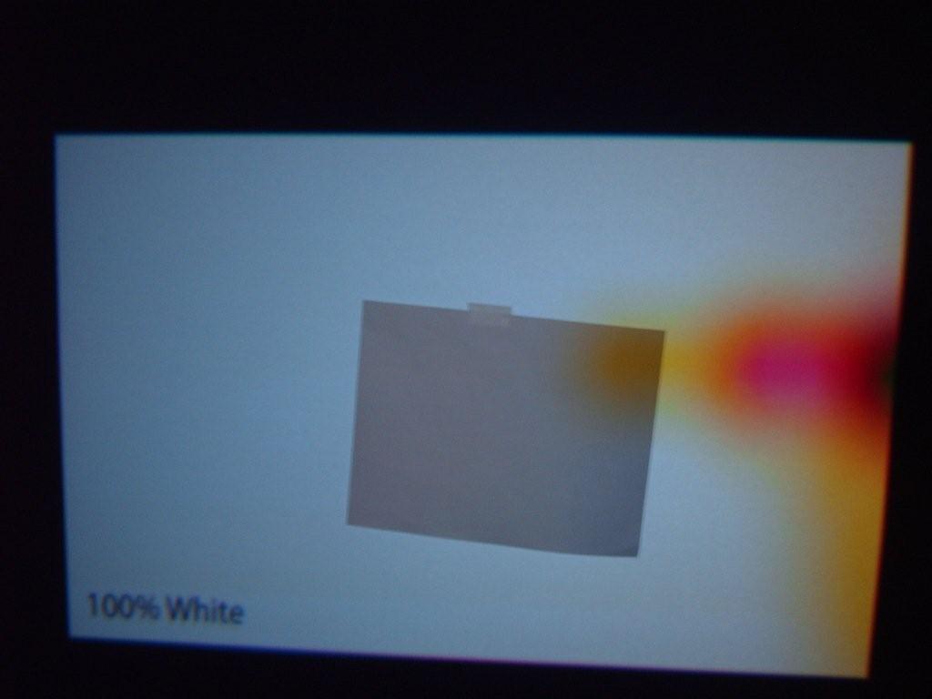

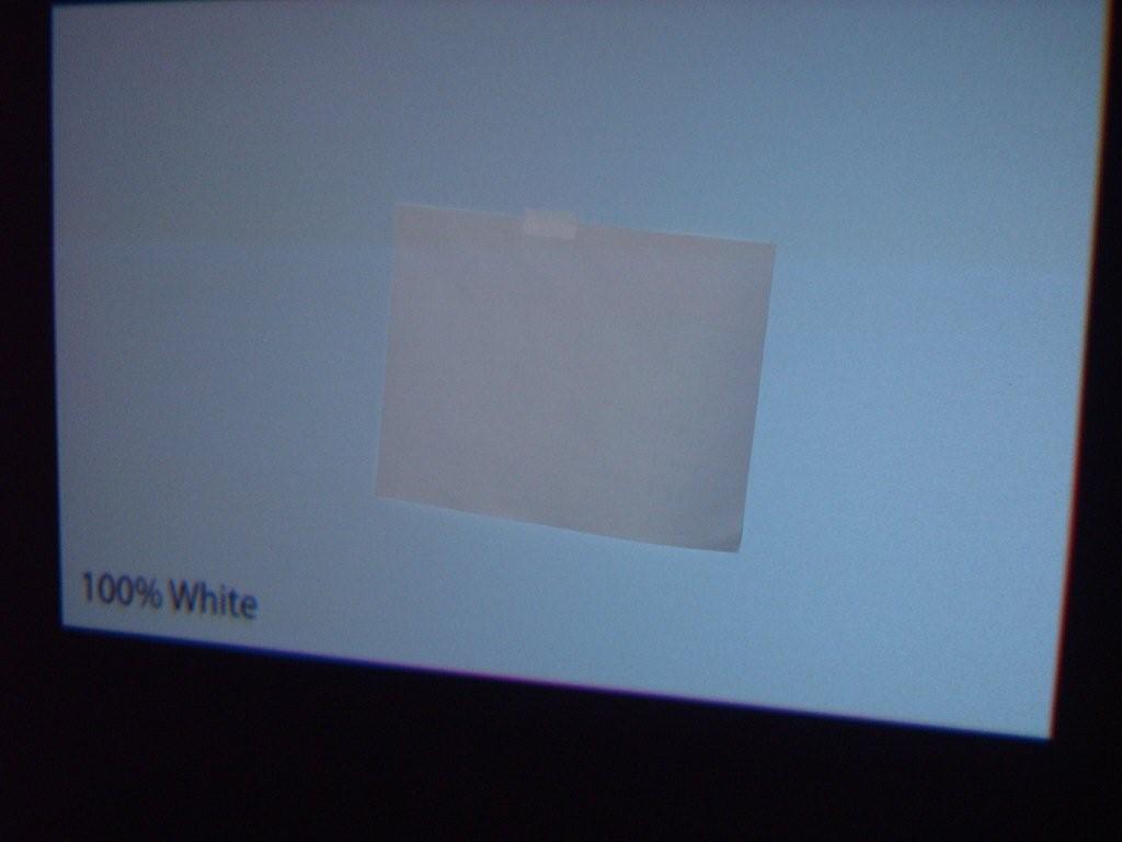

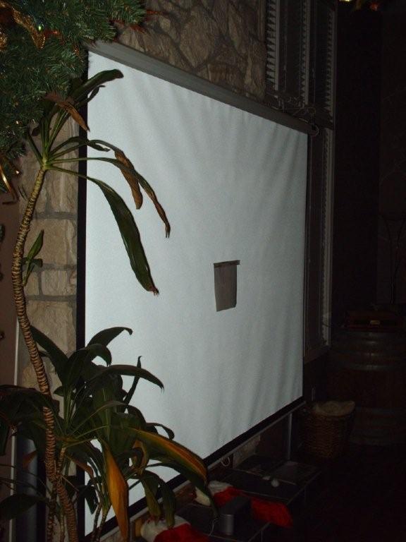

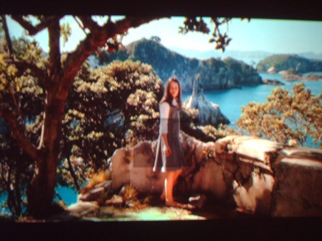

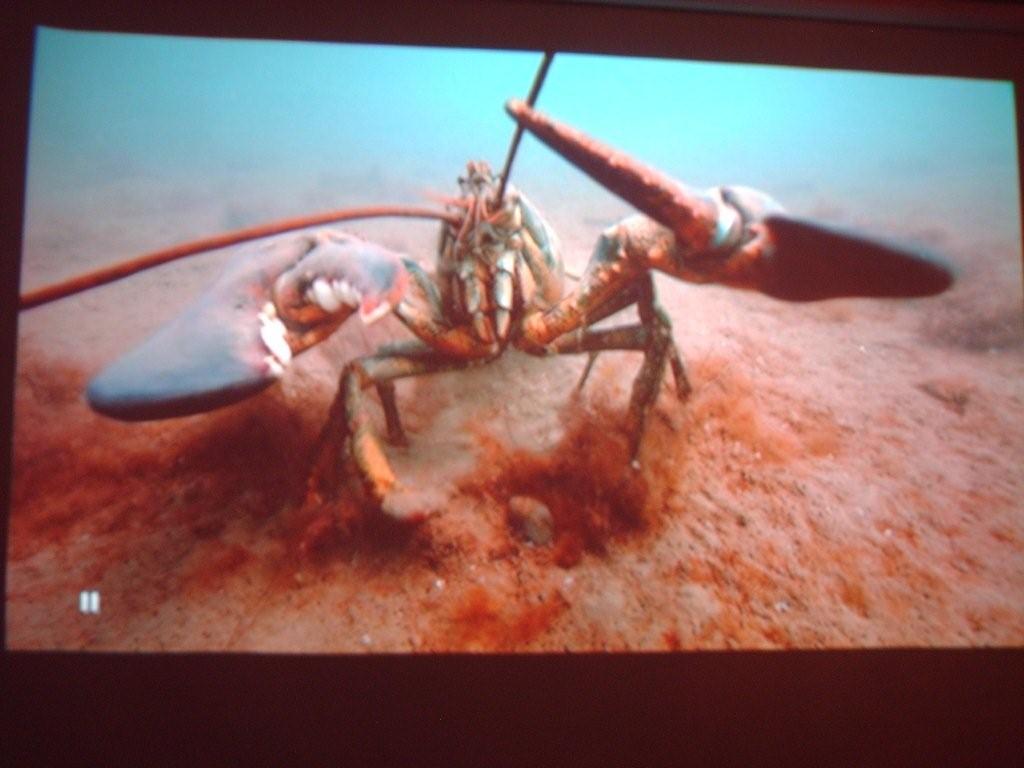

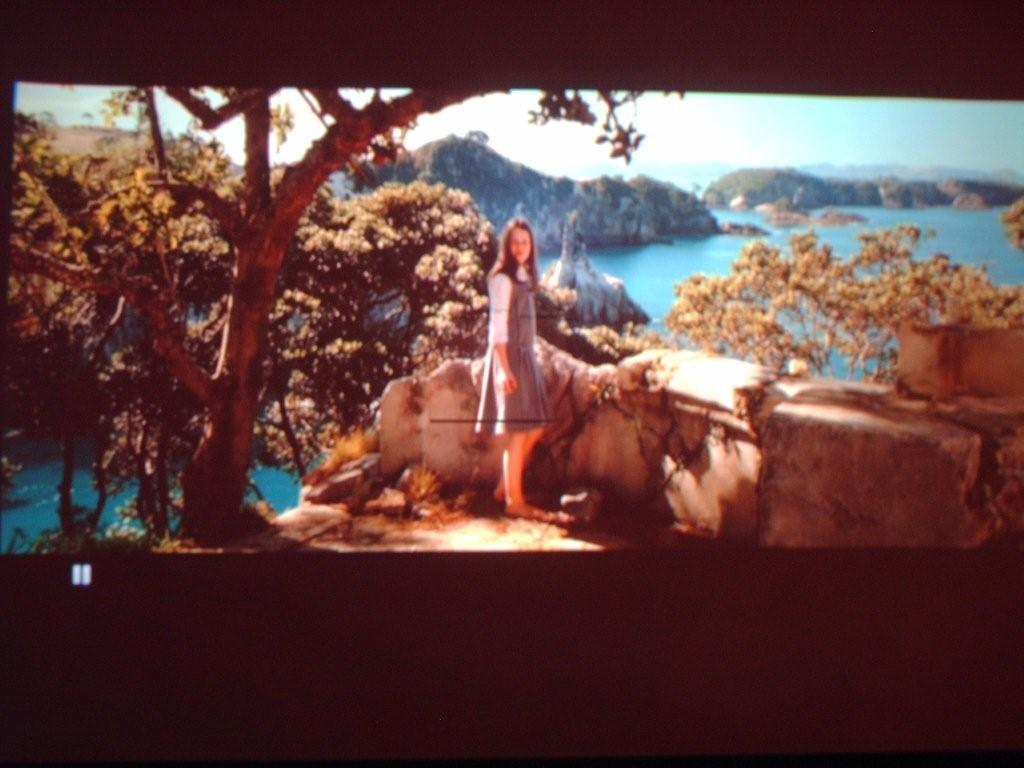

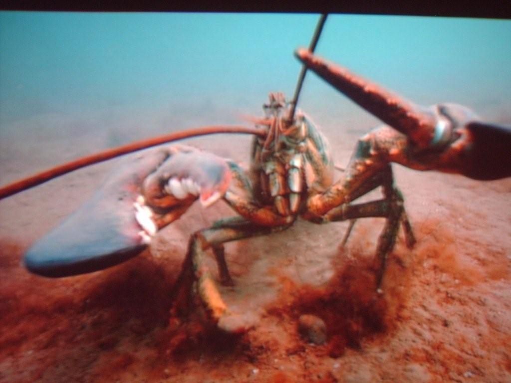

Ok, sorry was gone so long. I was playing with a piece of paper and my stupid camera.
I'll continue to edit this post and add pictures...
Look at the name of the file (stand or sit) and it will tell you if I was standing or sitting for the same picture.
I didn't use the paper in all of them. In the pnes where I used it, it's in the center of the screen.
MY CAMERA SUCKS!!! It's not red, the camera does that and there's 1500 mini-lights flashing as well. Wink
Man those shots look like a$$. I swear it looks nice and sharp.

Wow is that a standard 8.5 x 11 sheet of white paper?

Yup, cheap photocopy paper coverpage from work.

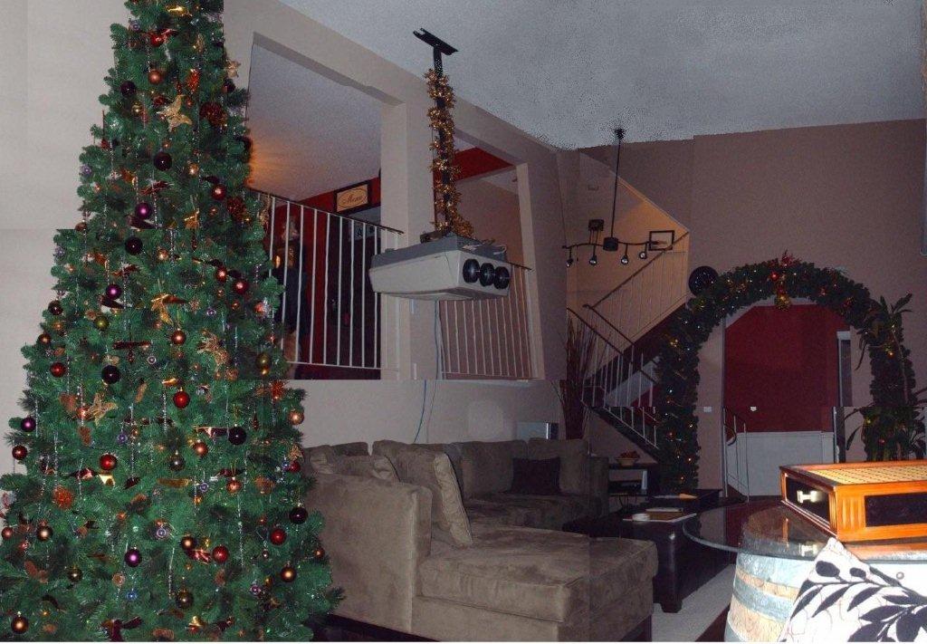

If I'm quiet for a few minutes, I'm trying to mix a bunch of pictures together for you since you like the room.
There were 9 photos to edit together. Still looks like a$$, but you get the idea.

thanks for taking the time to do all the photos, and provide the extra commentary. I also like the open feel of the room... really nice.
Gary already covered the screen waves pretty well, but you should know they're not bad at all, and unavoidable with any pull-down screen. The retro-nature masks them really effectively, and they'd have to be significantly worse for you to ever notice them during a film, and then only during certain pans. So you're in good shape there.
On the LobSitting/LobStanding shots I'm not sure how you can tell if the lobster is sitting or standing? J/K. Smile BTW, don't worry about the focus on the camera (pretty blurry, but that's common to screen shots). All we're looking for here are the screen illumination characteristics.
I am a bit confused though on the sitting/standing differences. Did you have the camera in auto-adjust mode? You'd really need to have a fixed aperture/timing setting to be able to compare anything. Also, there's the oddity that your standing pictures (which put you closer to the light source) are darker than the sitting shots. That's backwards, and I'm surprised no one has commented on it yet.
Ah, yes. The paper. I see you must have used auto settings. The paper is going to be approximately the same, regardless of sitting/standing. So when standing, the screen gets much brighter, making the paper look dark, as the camera adjusts. When sitting, the screen gain drops off a lot, and the paper starts to look comparable. It's inverted, but it still tells the story pretty well.
One thing to keep in mind about the retro screens though is that even when you're not able to get the full benefit of maximized gain (the usual case), you still benefit from the uniformity characteristics, and lack of hot-spotting. That's sometimes overlooked. On an angular-reflective screen, edge falloff can be an issue, especially with gain. And higher gains mean hotspotting.

LOL. I thought the same at first. But there's nothing magic about it. He's simply using an Acme AGSU2000. (Anti-Gravity Suspension Unit) Waiting for the road-runner to come along. Wink
Gary mentioned:
> Looks like your viewing spot is well below the projector... <
I thought so too. That would probably put your eyeballs at ~4' below the centerline of the lenses (when seated). I'd guesstimate your eyeball to screen distance at ~14 feet? That would make your viewing angle ~16-deg, and hence the gain at <1.5 (possibly 1.2). I have no details on the EluneVision, but could run the numbers from DaLite HP, if you provide the measurements. Of course, the important thing is if it looks good to you (whatever the numbers turn out to be), and it does. Others may need more data for comparison/evaluation purposes.

Tim is right -- it's the difference between "screen" and "paper" I was looking for, since that will compensate for the camera's adjustments. In the "sitting" pictures, it looks to me like the screen isn't any brighter than the paper. Especially the picture of the girl, where the paper doesn't seem much different at all. Which says to me your gain in the sitting position is something close to 1.0 -- you're not getting much "gain" benefit from the screen. But as Tim said, you still benefit from the uniformity and lack of falloff on the edges. You may also get some colorshifting as you move from left to right, but not as much as if the projector was table-mounted.

Sorry about the no fixed focus, it's a tiny point and shoot HP Photosmart E317, 5 MP camera. It's great for taking to weddings and such because I get a few hundred shots with my 2 AA rechargeable energizer batteries so I can shoot the whole event in a tiny camera... Well, it was really tiny when I got it several years ago. I know smaller and better can be had now. I don't have a tripod, but I have used the dining room level, under the railing for stability in the past.
I sit about 3 feet under the projector and the distance from my eyes to the screen is almost exactly 10 feet. The room is only 12 feet wide and the screen is in front of the mantle which comes into the room about 10 inches. Usually, I'm leaning forward in exciting moies so my viewing distance is about 8 feet then. Wink
