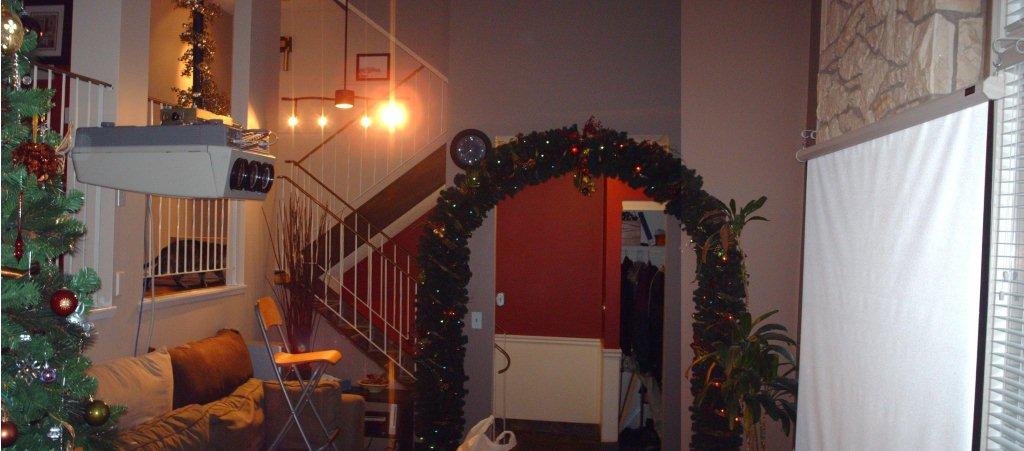

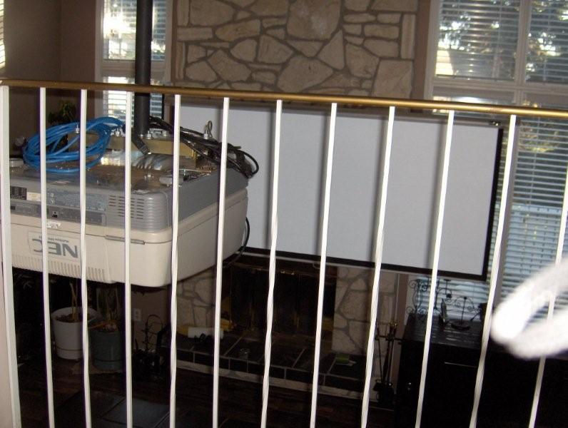

I took this picture specifically to show my setup/ seating. As I was told with CRT you should sit right under the projector to get the "sweet spot". As you can see it's in my family room and not a light controlled basement. Thankfully it get's dark at 5Pm these days. Razz Let me know if you need any other info. I see now the screen has some waves to it. I guess that's the down side of having such a large pull down screen. It's obviously brighter in the Sweet spot, but even in the dining room (behind the projector) or sitting off to the side, the image is still nice and bright.

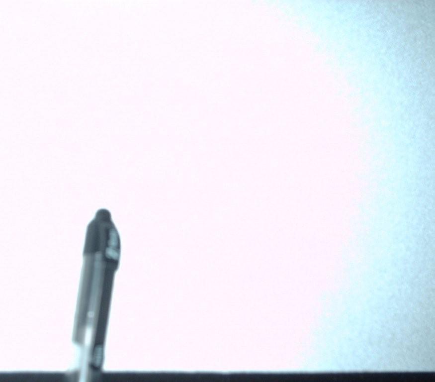

Sorry just noticed the bead size comment... Let me look...
Ok, it's about as coarse as 300 grit sand paper (though not as rough obviously). See the picture with the pen. The camera was only about a foot away with the flash. If you look to the right side you can see the texture of the screen and see how tiny the beads are. They're freaky small. My dad has an old glass bead slide projector screen and the beads are a lot bigger on that screen.

You know when I first looked at that projector in the picture above I coulnd't see what had it suspended. It's a 'magic' NEC floating CRT. Very Happy
Interesting house, very open concept

That's funny how the angle worked on that. That's my Chief mount. See my album for pictures of it. My wife wanted the garland around it. It works and the CRT is allowed in the living space so I don't care.

Waves on the screen shouldn't be a big deal. One of the advantages of retro screens is that they're basically insensitive to waves. For the same reason you can't make a torus with a retro -- the angle of the screen doesn't affect the reflection back to the light source -- the little ripples on the screen will probably be unnoticeable from the viewing position.
Looks like your viewing spot is well below the projector -- assuming you sit on the couch, not on that little folding chair. That's similar to my setup. I tested a piece of Hi Power and found it had about 1.0 gain or less at my seated viewing position. If I stood up it was BRIGHT but I didn't plan to watch movies that way! How far are your eyes from the lenses, and what kind of gain are you getting? If you put a white piece of printer paper on the screen and sit in your viewing position, does the paper look white or dark? If you stand up I bet the paper looks dark (because the screen looks so bright).

How long is that drop pipe for the mount?

That particular extension arm is 4 feet to 6 feet. I have a 12 foot ceiling so I needed to get a long one. I have it at about 5 feet. I'm 6'1" and if the couch wasn't in the way the projector would just brush my hair. If you get a short 6" tube that doesn't extend it's much cheaper. I like how you could run cables through it if needed.

Even to the naked eye the waves aren't that noticeable. It was only in the picture it made them obvious. The folding chair was just up there to get it out of the way. We'd just finished decorating and hadn't cleaned up yet.

Yeah, probably the only reason you can see the ripples so clearly in the picture is because you're sooo far off to the side. At that sharp angle, the ripples are very noticeable. Even though the retro screen isn't very sensitive to angle, it will show some difference between "angled toward the camera" and "angled almost away from the camera" ! The far side of each ripple is almost facing away from the camera, so the flash barely hits it & not much bounces back to the camera. From the viewing position that shouldn't be an issue.
