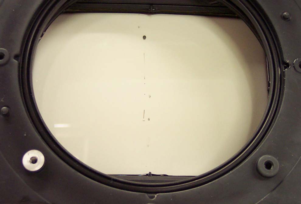

G90 Spot burns on new Tubular tube? Seen antying like this?
zGman
Joined: 22 May 2006
Posts: 599
Posted: Thu Oct 30, 2008 7:21 pm    Post subject: copy of avs post
Hi Kris,
Here is a closeup pic of the results of a beam collapse on a G90, (actually
multiple collapses, since it happened several times during testing.)
I have three tubes (RGB) with this type of damage, and plenty of pics -
if you need them just PM...
I think it should be obvious that there is nothing subtle about it.
If your g90 was having a problem, all your tubes would be burnt -
just like this - all together at once - end of story.
Your experience will certainly influence any future consideration
of doing business with this company, for myself and many other
CRT enthusiasts. I find it very unsettling that they have been
unwilling to continue to work toward an equitable solution.
G

Posted: Fri Oct 31, 2008 1:30 am    Post subject:
I think I will proceed with the suggestion of sending the tube to VDC for a second opinion.
In the mean time I have opened a dispute with PayPal, since the transaction actually happened in September it seems prudent to start that process immediately. Here's the message I presented:
The auction clearly presents NEW PANASONIC P19LUG CRT Tubes.
1. The fist tube sent had silicon residue from a previous mounting and had scratches on the glass face of the tube. Did not appear new, unclear if it was used, but was not acceptable. Was returned and promptly replaced with a second tube.
2. The second tube looked fine to the naked eye, but the label on the tube does not appear to be anything like the Panasonic label on the tube pictured in the auction. Does not appear to come from Panasonic.
3. Upon installation the tube showed blemishes that appeared to be on the phosphor surface from the very first time it was powered on. Photos available on http://www.vidya.com/kris/G90
Contacting the seller, was instructed to send it back to them for examination. Seller's technician contacted me and declared the blemishes were from spot burns that are not covered by the warrantee.
Business contact has refused to respond to my requests to speak to them directly.
Experts within the CRT community agree that the blemishes do not appear to fit the standard profile for spot burns, and appear to be more characteristic of phosphor defects. Seller's technician himself admitted he has not seen that type of burn in the past and can not suggest a reasonable explanation of how my equipment could produce such burns.
Obvious quality control failure on the first tube sent makes me suspicious of the claim that the second tube was flawless when it left the seller, and the inability of anyone to explain how my projector could damage the tube in this way leaves me unsatisfied with the situation.

"You buy a CRT from any other company and burn it, see if they will replace under warranty."
How is that relevant when the tube in question here was clearly not burned as stated by many reputable CRT gurus?
Or at least no one can figure out how it can be burned in such a way that it would make those spots.
Although we can only judge by what we see, and thus far no representable pictures have been shown with enough detail to make an clear judgment of how it behaves in different conditions. Such as showing the clear tube etc.

btw the similar spot i mentioned earlier appears to be a microscopic bubble just about visible to the naked eye if you look for it. It sill looks like the pictures posted on screen though.

Caligraphic:
The type of phosphor impurity or uneven coating as seen on KrisRoberts's tube is not always visible upon QC after production.
In some cases it materializes within the factory burn-in period of 100 hours, but unfortunately about 10 percent of affected tubes will only show the visible defect after about 200-250 hours of regular (i.e. 100 percent within specs) use.

despite my earlier spot i feel the need to reply as you seem to have evaluated this CRT in order to be so specific in you evaluation.
There are two distinct BURN patterns. i am very aware of the type of coating issue you refer to.
The two image issues on the crt in question is a distinct burn with phoshor hole down to glass and at a vector from this burn is a partial burn. On another section of the crt approx 3 inches away from initial burn is another burn and at EXACTLY the same vector from this burn is a very very similar partial burn. now forgive me for being a little ciynical here, but it looks like a dog , it barks like a dog and by golly it is Burn.
But there are a number of email posts here from people that know a great deal more about this issue on this CRT than and feel the need to burn my company at the stake i yet i am the one looking at it on my desk.
now if the customer in question really did ship it all around the community and allow all of these experts to power it up and see it sufficient for them to make these comments i would suggest that maybe one of these experts burnt the CRT.
like i said i am little cynical right now.
i am sure you will all have more luck elsewhere. i know i do. i am prepared to stand behind my service and also behind the report on this crt that will prove my stance here. either way, we are not cut out as a company to deal with this. We will deal directly with the people who know us and apparently trust us and keep it that way.

Posted: Fri Oct 31, 2008 9:58 pm    Post subject:
So the pictures posted by the OP is not representative of the issue?
They show three dots but you mention two burns.
I can't see any vectors or trails ether. (not that the pictures posted is up to it anyways)
Are you talking about the same tube?
Terry said he did not see anything when looking at the tube. So I guess nothing was plainly visible at the time.
Is it plainly visible now?
I kind of scratching my head here.
Not that it was any of my business in the first place, I only said what I saw.
Now I'm not sure what's what.
