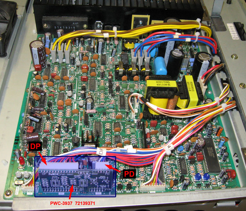

Mine is:
PWC-3709A
72137094
"1X8-152AJ" (could be "1X0" - stamp is somewhat hard to make out)
Also, can you confirm the presence of the "PD" and "DP" daughterboard (or lack thereof)? I have noticed that photos on this site do *not* show this module. I cannot find any information on it, but wonder if it is common between boards or not. Also I wonder if a projector with this extra daughterboard can also work with a deflection board that does not have the daughterboard.
If anyone has any insight then, by all means, please jump in.
PWC-3709A with "PD/DP" daughterboard

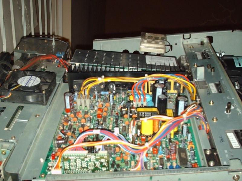

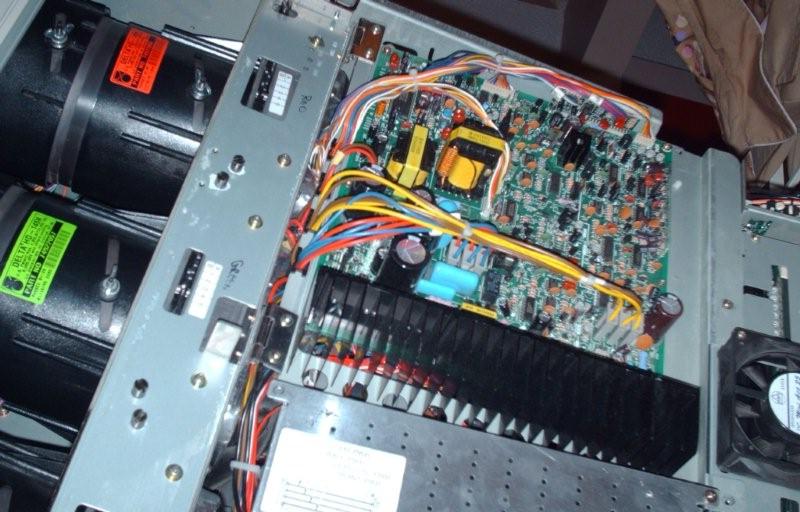

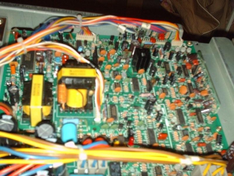

Ok, sorry my camera REALLY sucks. The projector is hanging form the ceiling again so pictures aren't as easy. I too have the PWC-3937. I couldn't see where you got the 72139371 number off that board.
I actually took that scrambled mess picture back when I had a TV in that room so I could "fix" the Playstation settings when it did that. I don't remember if the menu's worked or not. I'm hosting dinner on Monday so I can't take the time to play with it right now, but I am off all week next week and I'll definitely give it another try. Here's some photos. Let me know what numbers you need and where to find them. I'll take the cover off and get you the numbers tomorrow.
 Filesize:  82.93 KB
 Viewed:  9899 Time(s)
 Filesize:  77.91 KB
lostmandan
Joined: 09 Jul 2008
Posts: 146
Location: Kitchener/Waterloo, Ontario, Canada
Posted: Sun Oct 12, 2008 5:09 am    Post subject:
That is definitely the same def board as I have. Can you confirm the ink stamp number (along the left edge of the board shown in 'other view pd dp board.jpg')? It looks to be something like '1X8' or '1X0'.

Oh, I see it now. I was looking at the little board. I'll take a look after thanksgiving. It actually shows in one of the pictures, but it's blurred just enough that I can't see it.

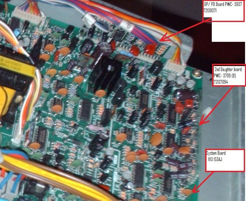

Here's what you wanted... My system board is very clearly 1X3 153AJ. I also included the spec's of the 2nd daughter board, even though I have no clue what it is/does.
I'm going to switch it to 1080P right away just to see if it garbles the system menu's too... I'll let you know how it goes. Shocked <gulp!>
Quick question... are games (well I'm using downloaded demo's) 1080P? When I play a demo, it won't use my Blu-ray input (that I use for 1080i), but the HDTV input I made for high def TV. If I'm playing a demo and I try to switch it to my Blu-ray input it says "invalid input".
 Filesize:  156.75 KB
 Viewed:  9854 Time(s)

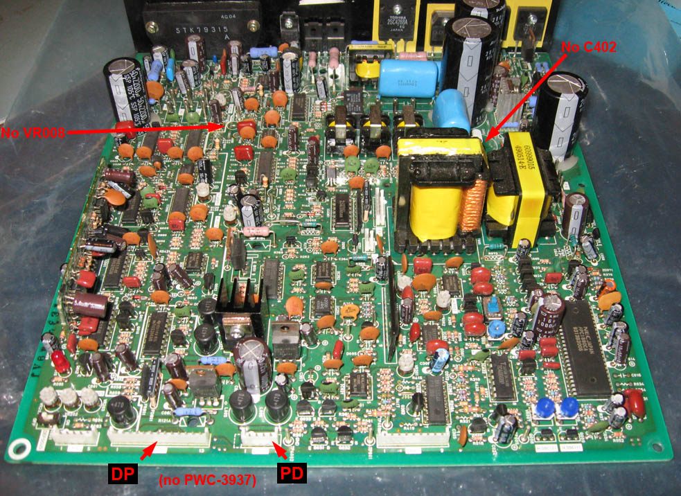

From what I can tell, the PWC-3709(B) is the V.POSI board (Vertical Position circuitry of some sort).
I have been looking closely at the images of the deflection boards you posted, the one posted in the Layout details on this site (http://www.curtpalme.com/NECPG_Layout1.shtm), and the one attached to this email.
It looks as though there are a few variations:
A) With "DP/PD" daughterboard (like your, like mine)
B) Without "DP/PD" daughterboard (connectors directly on DEF board)
C) Without "DP/PD" daughterboard, and *different* component population (see attached picture)
The '72139074' number indicates the PCB is the same (Rev 4), but for some reason NEC decided not to populate some components on some board (notably 'VR008' and 'C402'). There may be others.
I would imagine that there were some changes over time. I believe this would correspond to ink stamp values in some way or another.
The following summarizes a few aspects of these boards:
    InkStamp: 1X8-152AJ
    DP/DP Bd?: Yes
    Miss. Component?: No
    1080p OK?: No
    InkStamp: 1X3-153AJ (could be 152AJ - ink stamp obscure)
    DP/DP Bd?: Yes
    1080p OK?: No
    InkStamp: 1W0-xxxAJ ('xxx' not legible in photo)
    DP/DP Bd?: No
    1080p OK?: Unknown
    InkStamp: 1E3-xxxAJ ('xxx' not legible in photo)
    DP/DP Bd?: No
    Miss. Component?: Yes
    1080p OK?: Unknown
Cheers,
Dan
PWC-3709 DEF PWB (missing 'VR008', C402)
 Filesize:  232.63 KB
 Viewed:  9810 Time(s)

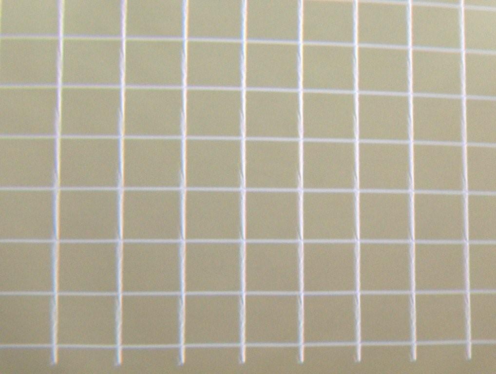

That's the odd thing. The scrambled mess only affects the image coming from the PS3. The projectors menu's look perfectly fine except they occasionally flicker.
It's not giving the "unregistered signal" error, so does that mean it is locking to 1080P, but just not resolving it enough to view?
Give me a couple minutes and I'll post a picture with the menu... it'll look like garbage since the sun is out now, but you'll get the idea...

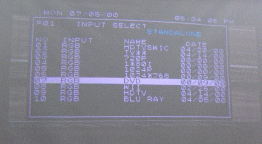

Ok, here's a couple photos. They look like crap because the sun is glaring through right now.
You can see the diagonal mess in the background of picture 2 and you can see how the test pattern has some jaggies on it. Both were taken with the PS3 ouptputting 1080p.

Correct, I do not believe this is the 'dreaded scrambled mess' because the on-screen display (menus, anything generated by the system board) is in sync.
In terms of only seeing this at 1080p from the PS3 - I am not sure if this indicates some divergence between your unit and my unit or not. I have noticed that any source that outputs a horizontal frequency above ~65KHz on my unit ends up with video displayed out of sync. Any signal with a horizontal frequency below this threshold is perfect.
The suggestion I would make is to check the horizontal and vertical signal information reported in Signal Info part of menu for each of the following cases:
1) With source (displaying correctly) at 1080p (or close to it)
2) With the source (PS3 in this case) displayed out of sync
3) If possible, 720p (or equivalent) using 65KHz+ horizontal rate. I acheived this by using the VGA out from a PC and power strip at 1280x1024 (and adjusting the vertical refresh until the horizontal jumped just above the point of failure.
What I noticed was (in each case):
1) In this case the horiz and vert frequencies reported were correct.
2) In this case the horiz was reported at ~1/2 of what it should have been (ie: 33KHz instead of 66KHz). Vertical reported fine (give or take 0.1 Hz).
3) In this case I also noticed the horiz was reported at ~1/2 of what it should have been (ie: 33KHz instead of 66KHz)
I used an oscilloscope and probed the test points at the H sync input and H sync output on the deflection board and noticed that the H sync input was always proper (even above 65KHz), but the H sync output magically divided by two on the output. In other words, the Signal Info was actually reporting the correct H sync rate because something was dividing by 2 on the deflection board.
At this point I am really hoping to collect various cases from people who also have these PJs and assemble information about ink stamps, presence of daughterboards/components, PCB revisions, and 1080p support to get an idea of what the pattern is.
If I can confirm that a few people with the "DP/PD" daughterboard are seeing the same issue at ~65KHz, then I conclude my unit is also working "properly" although not to the spec of 90KHz (as per service manual). Then the question is "what needs to change to make it perform to spec?".
Thanks again for the time and effort to investigate! Cheer, Dan

Mr Green, your projector needs a new deflection board.
Give it a break and run 1080i. It's 15 years old or so now...

Mark_A_W
Joined: 15 Mar 2006
Posts: 3068
Posted: Fri Oct 17, 2008 9:41 pm    Post subject:
Because the menus are fine, so it's probably not the system board.
The Sync is screwed, and that's done on the deflection board.
I'd just upgrade to a LC projector, or run 1080i. I wouldn't spend any on the Plus.
