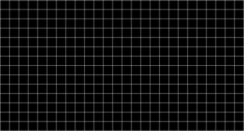

I'd like to point out that there are certain installations which won't require Scheimpflug. My old 1271 was apparently installed at or near the ideal throw angle and screen sizer for the installed spacers, because I never had a problem with dissimilar sharpness across the screen. The side-to-side and top-to-bottom focus was almost identical. So, if a particular setup's focus is similar across the screen (i.e. the top-bottom and left-right focus as are similar or identical), then adding a flapping mod won't gain you much - if anything.
On the other hand, I installed a friend's 1272 that had "rear" spacers installed - that is to say rear projection zero-degree throw angle spacers. When we set it up as a floor-mount with a fair amount of throw angle, we found out it wouldn't focus worth a crap at the top or bottom of the screen. If it was sharp in the center, the top and bottom were soft. If we focused at the top, the bottom was horrible (and vice-versa). I went through a box of hardware and found some various-sized washers. By trial and error, I found a washer about 1mm in thickness, that when used to shim the top of the lens out, brought the entire screen into focus perfectly. That's flapping.
Nobody wants to screw up their setup to illustrate the effect, but I'll attach a JPG that shows exactly what it will look like if the plane of focus isn't parallel to the screen. This isn't much worse than the 1272 looked before I put the 1mm shims in place. It doesn't take much!
Plane of focus not parallel to screen (simulated)

Posted: Tue Aug 19, 2008 12:34 am    Post subject:
A picture paints a thousand words and shows what 1mm can do!!

Posted: Tue Aug 19, 2008 3:49 am    Post subject:
Focus may not be great but damn that geometry is perfect. Mr. Green
Mike
Posted: Tue Aug 19, 2008 3:55 am    Post subject:
I was thinking the same thing... Wink
Posted: Tue Aug 19, 2008 4:42 am    Post subject:
Yeah, I worked pretty hard on it. It took awhile to get it that good... about 15 seconds, I think... Wink
Oh, man... If only it were as easy to nail the size and linearity controls on the projector as it is to click the "Pattern" button in the "Fill" dialog in Photoshop and click "OK"!!!
