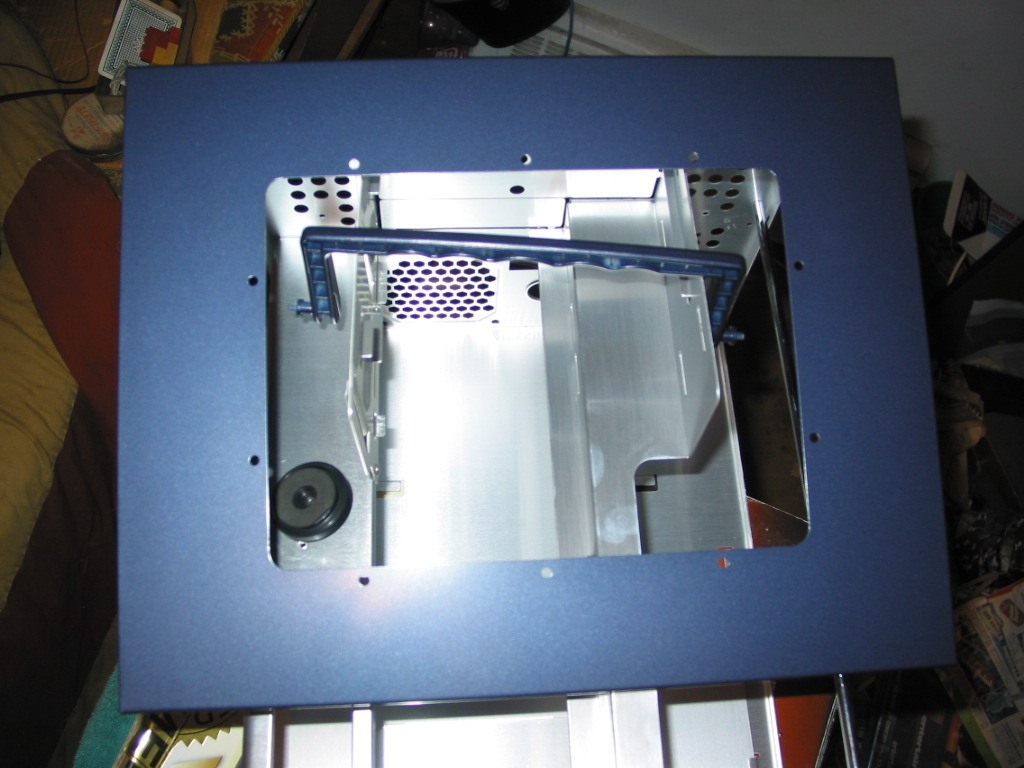

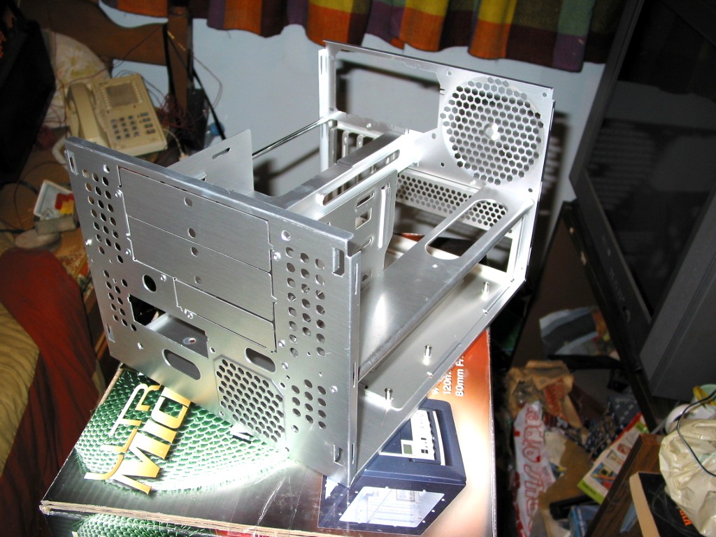

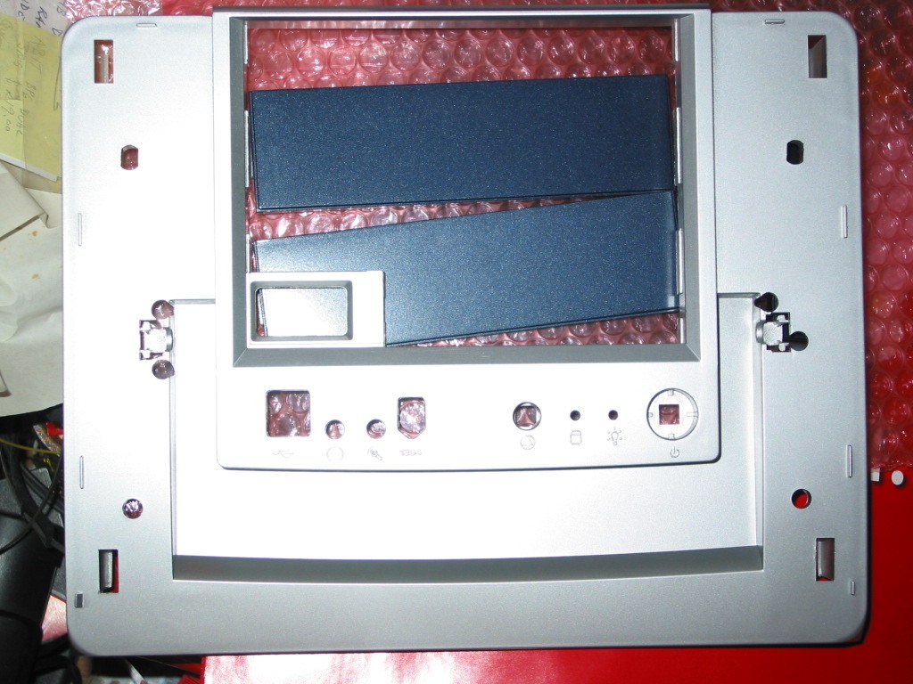

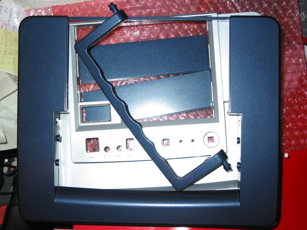

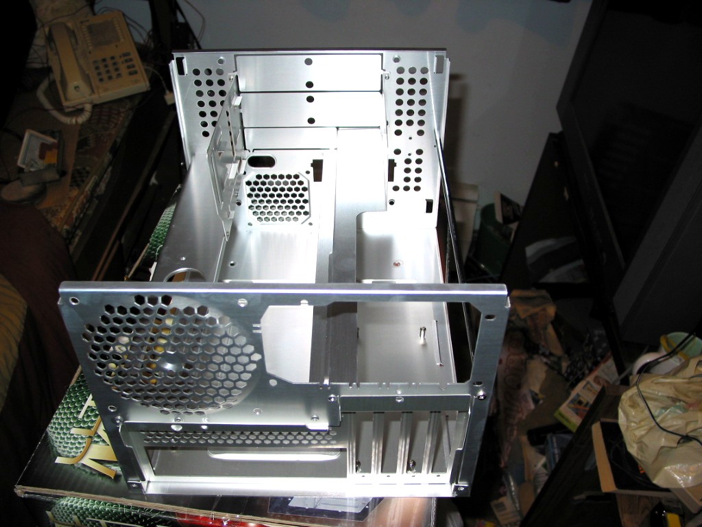

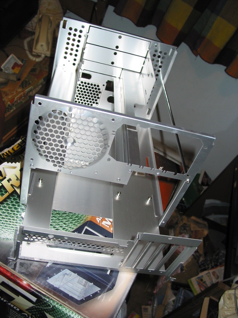

Posted: Fri Nov 24, 2006 2:30 am    Post subject: THE FINAL BEFORE PICTURES
Ok I finaly dissasembled the system for painting. Here's a couple of pic's
The inside of the aluminium case and the motherboard tray will be gloss black. The inside face plate will be semi gloss black. The outside face plate will be lemon/lime yellow green color flip.
The outside pannels will be semigloss black with the plexi glass windows.
It'll match my 1984 Supra. Why? Just for the geek factor.
Outside Pannel (3 pieces total only one shown) curently a crappy blue color.

Inside face plate
 Filesize:  181.19 KB
 Viewed:  21203 Time(s)
Outside face plate
 Filesize:  212.4 KB
 Viewed:  21205 Time(s)
Slide out mother board tray.
 Filesize:  187.1 KB
 Viewed:  21330 Time(s)
Rear view
 Filesize:  166.29 KB
 Viewed:  21210 Time(s)
It's nekid!
Front View
 Filesize:  199.12 KB
 Viewed:  21218 Time(s)

Posted: Fri Nov 24, 2006 2:46 am    Post subject:
Here's how the paint job breaks down:
For the Glossy Black parts on aluminium:
3 coats of self etch primer, 2 coats of midnight black base, and 3 coats of clear.
For the Semi Gloss Black:
A sanding with 400 grit sand paper, 3 coats of high build primer, 2 coats of midnight black, 3 coats of clear with flattening agent added.
For the Lemon/Lime:
A sanding with 400 grit sand paper, 3 coats of high build primer, 3 coats of arctic white base, 2 coats of lemon/lime color, and 3 coats of clear. Let stand for a week and wet sand with 1800 -2500 grit to a mirror finish.
I hope this turns out as well as (most) of the Supra did.

Posted: Sun Nov 26, 2006 8:06 am    Post subject:
For the Lemon/Lime:
Well aparently doing detail work is expensive. When he saw the chassis he quoted me $500(!) for the job.
So...
The front panel will be lemon/lime and the top, and 2 sides will be semi gloss. I'll have a crack at doing the single component gloss black on the inside chassis myself or try the shop that painted my truck black. It turned out nice.
