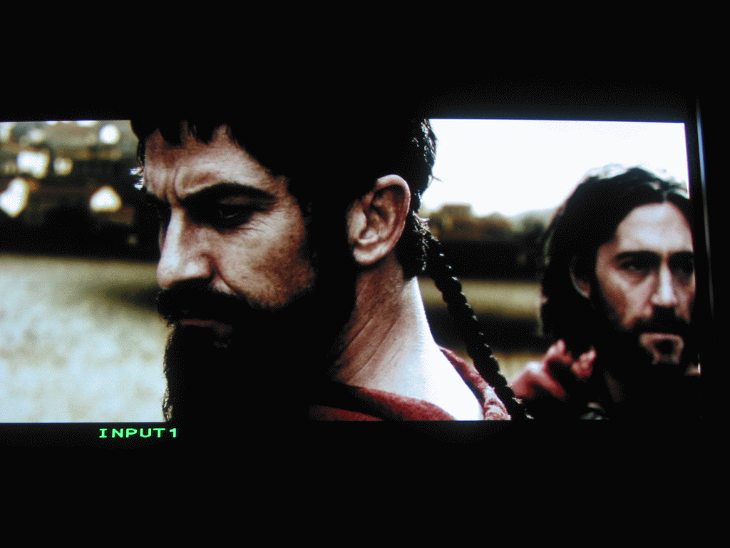

The Ampro does have a frequency counter built in. You can view the incomming frequency on the remote. ( Cool huh? )
You know the one thing I did notice ( and I'll update my previous HD Fury post ) is slightly blown out highlights via the HD-Fury. Have another look at the '300' screen shots. They look like the white is overblown in the sky.
EDIT:
Also notice slightly more detail in the faces and a better color saturation with the HD-Fury.
Posted: Tue Feb 12, 2008 6:42 am    Post subject:
Here's an example of what I'm talking about. It's easier to see in a GIF for the A/B comparison.
Look at the wrinkles around his eyes.
Input 1 is HD-Fury,
Input 2 is VGA-Analog
 Filesize:  336.04 KB
 Viewed:  15025 Time(s)

A couple more:
When I compare Images 5109 to 5110 and look at the stars in the background of the 20th Century Fox logo, why is it that 5110, the VGA output, appears to be sharper? At first I thought it was my imagination, but I am not creative enough to imagine this. The VGA output (image 5110) is sharper to my eyes.
EDIT:
Also notice slightly more detail in the faces and a better color saturation.
That is cool about the ampro remote.
Great A/B comparison, I think movies like 300 & Jarheads are not really great flixs to judge gama unless you have a reference screen shot. The first HD-DVD I bought was Jarheads, needless to say I never used it for a demo the whole thing has that blown washed out look.
Mike

300 may not be a good movie for calibrating but I can clearly see a difference between the two. Also if you look at ice age close up squirl shot, the whites of his eyes seem blown out slightly.
