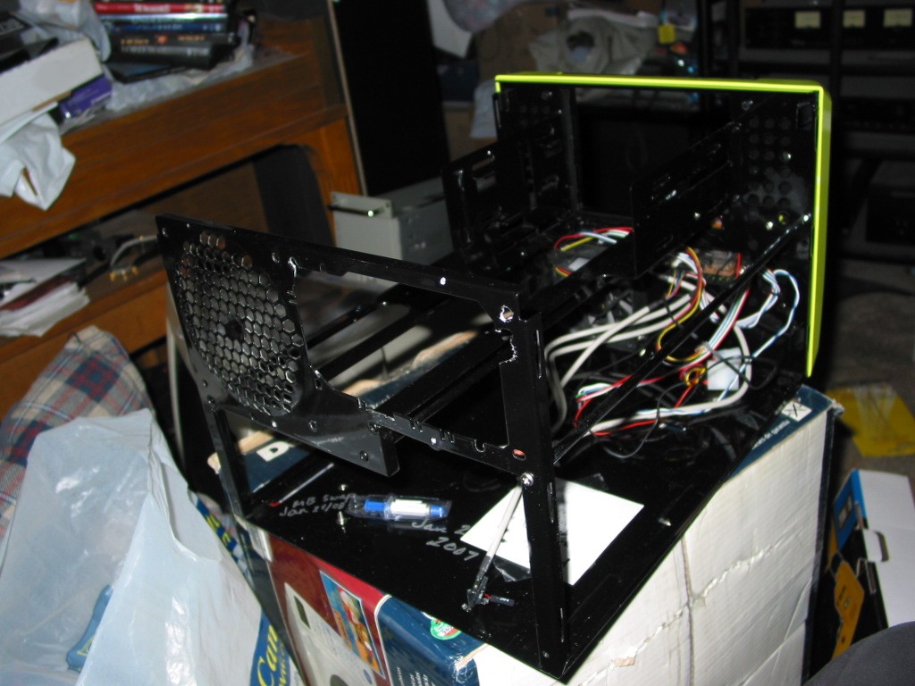

Well it's pretty bare. Unfortunately I grabbed an eSata port with too short a cable ( it was a gimmie ). At least I have some of the holes drilled.
I'll see about putting it back together tomorow.

Posted: Tue Jan 29, 2008 2:54 am    Post subject:
Got the holes cut for the eSata connector. I slipped a little while I was dremeling. Hard to watch Worlds scariest video and cut metal ( accuratly ) at the same time.lol

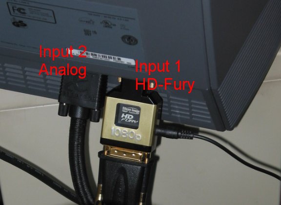

I also recieved my HD-Fury last week. I hooked that up to 'Input 1' on my montor
and ran the analog cable into "Input 2"

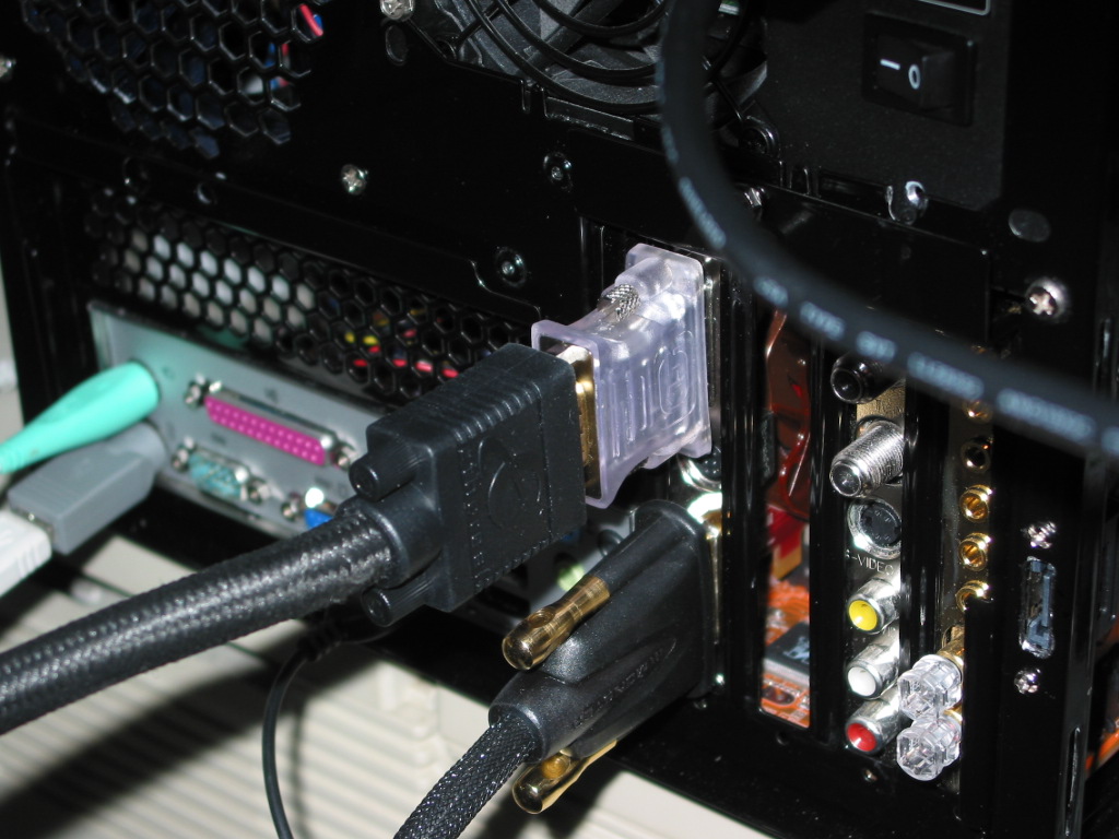

I ran the Etherial analog cable off the DVI-I to VGA adaptor and the HD-Fury off the MC DVI-D to DVI-D cable.
Like this:
Analog Top
Digital Bottom

Sony G520 dual VGA HD-15 inputs

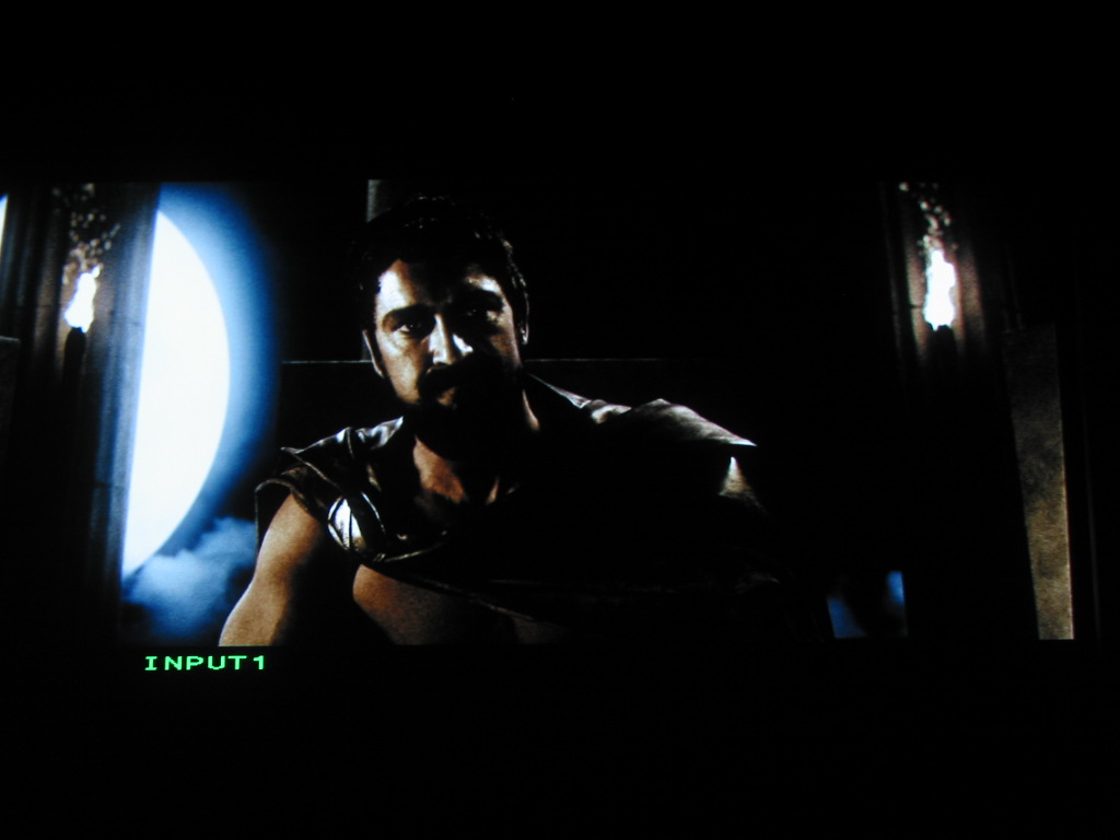

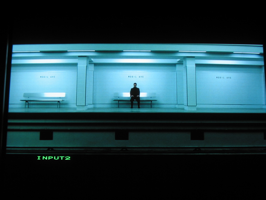

OK great. I wanted to do an A/B comparison of high quality (Etherial 12 foot VGA cable )
vs. HD-Fury (ahem. Monster Cable 12 foot DVI-D to DVI-D ) ( I know MC isn't the greatest but it's literally better than nothing ) with USB power cable off the HTPC USB port (with out this I got a black screen at 1080P )
vs. Moome 2005 DVI card
vs. Moome 2007 DVI w/gama
( both cards installed in a Sony PC1271 switcher )

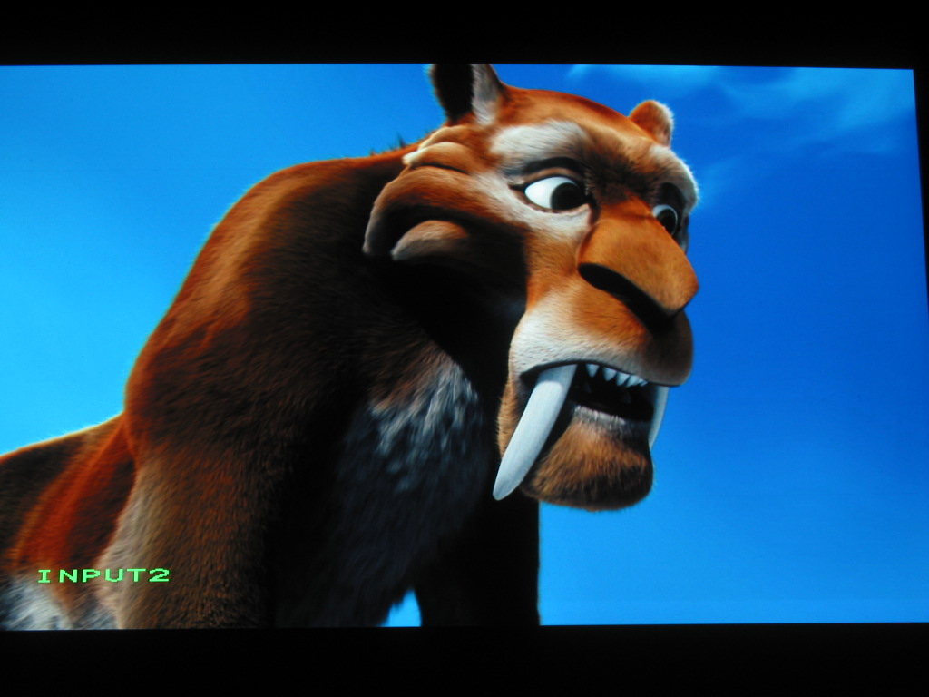

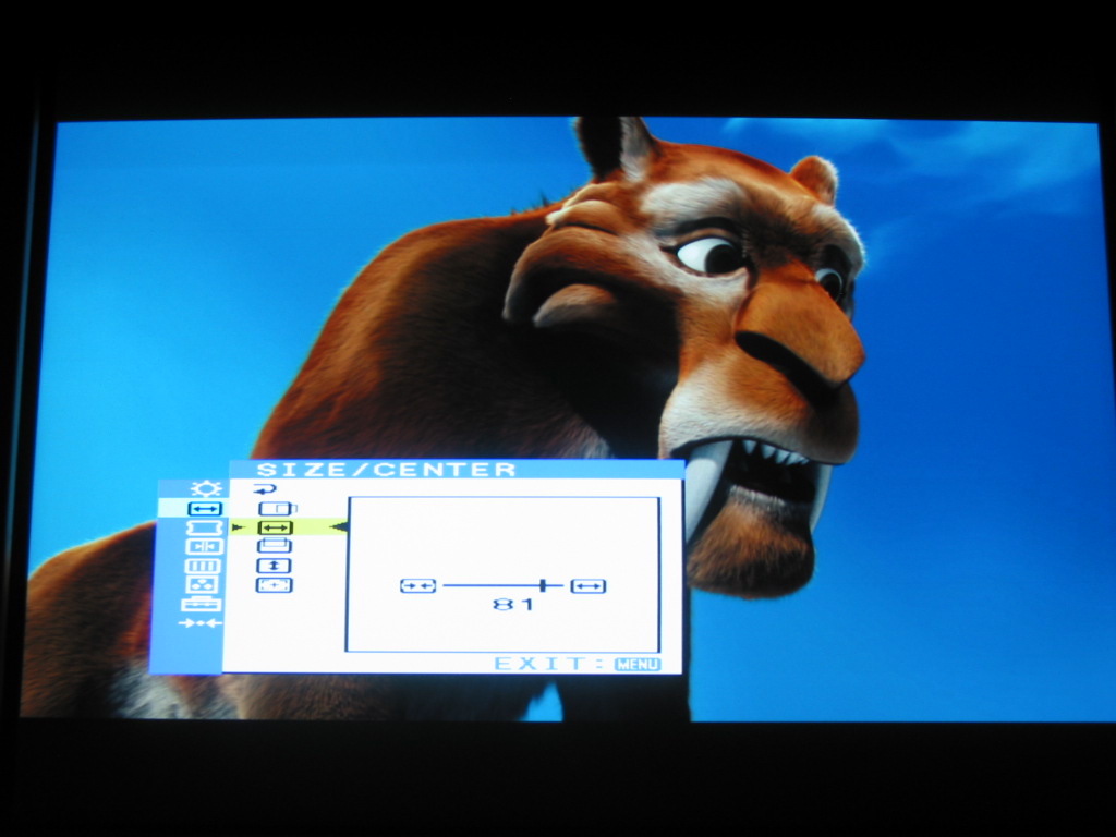

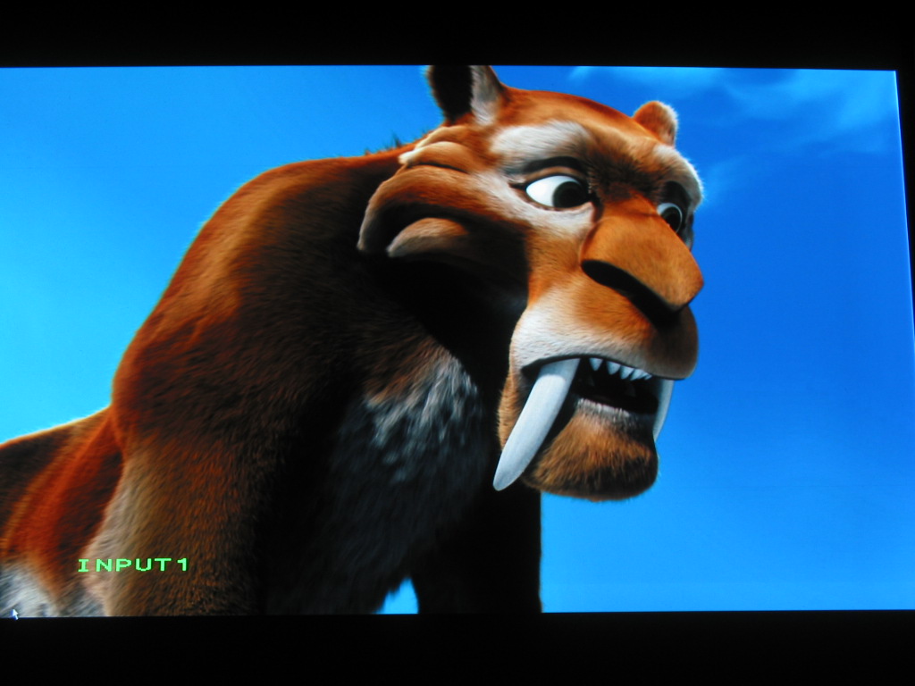

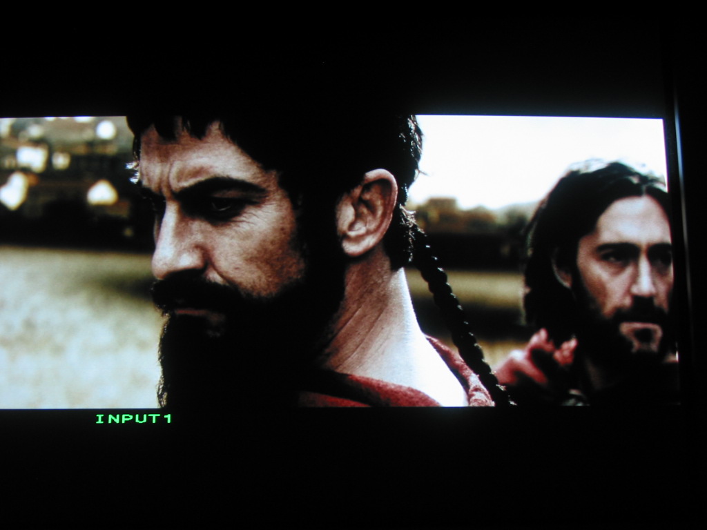

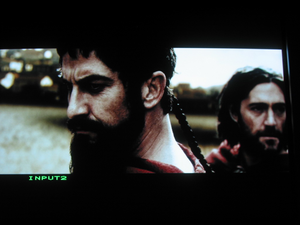

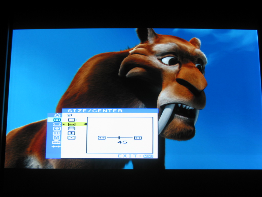

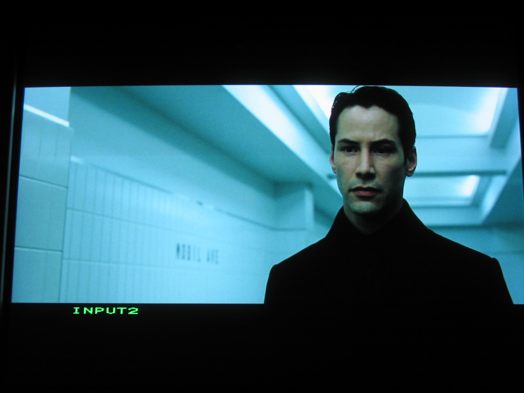

What I found was interesting. I got the left image shift that everyone talks about with the HD-Fury. It also horizontally stretched the image and I had to compress it using the monitors controls. I saw some vertical banding on the left side of the screen that's not present there with the analog input, and the timings were different on the HD-Fury. Look at the right side of 5117, you'll see a bright line where the image folds back on its self. I estimate an image cut off loss of 5-8%.
No matter how I set the monitor controls I could never recover the missing image.
Ignore the horizontal line in 5118 that runs past his ear. That's not actually there, It's a product of the photography.
To make this a fare comparison I set 'Input 1' and 'Input 2's color's and brightness the same for both inputs.
See Fig.5117, HD-Fury Input 1
& Fig. 5118, VGA, Input 2
below:

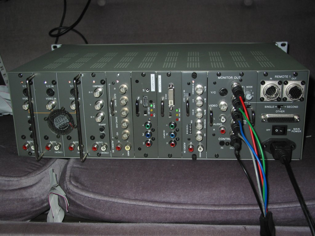

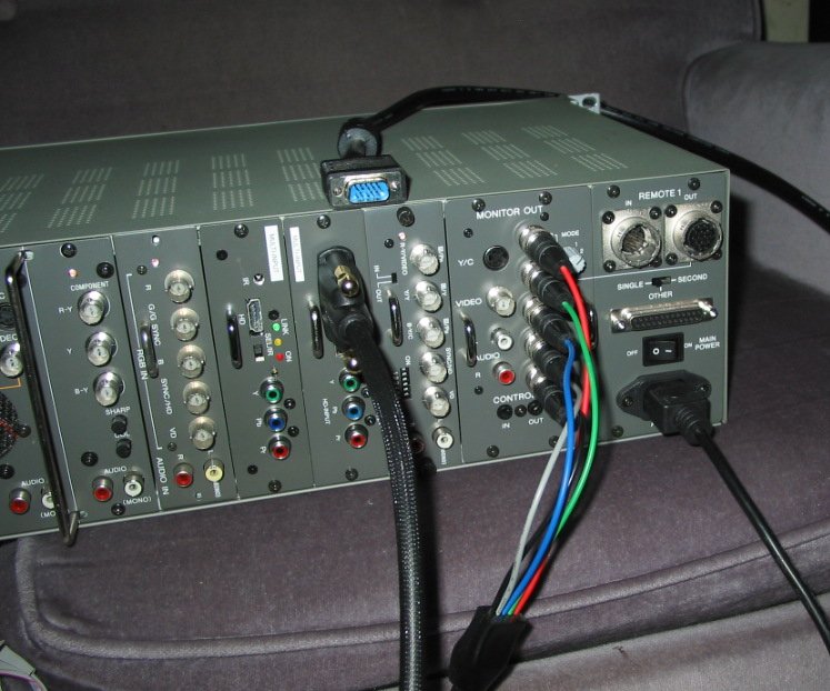

Sony PC1271 Switcher w/ Moome HDMI and DVI cards installed.

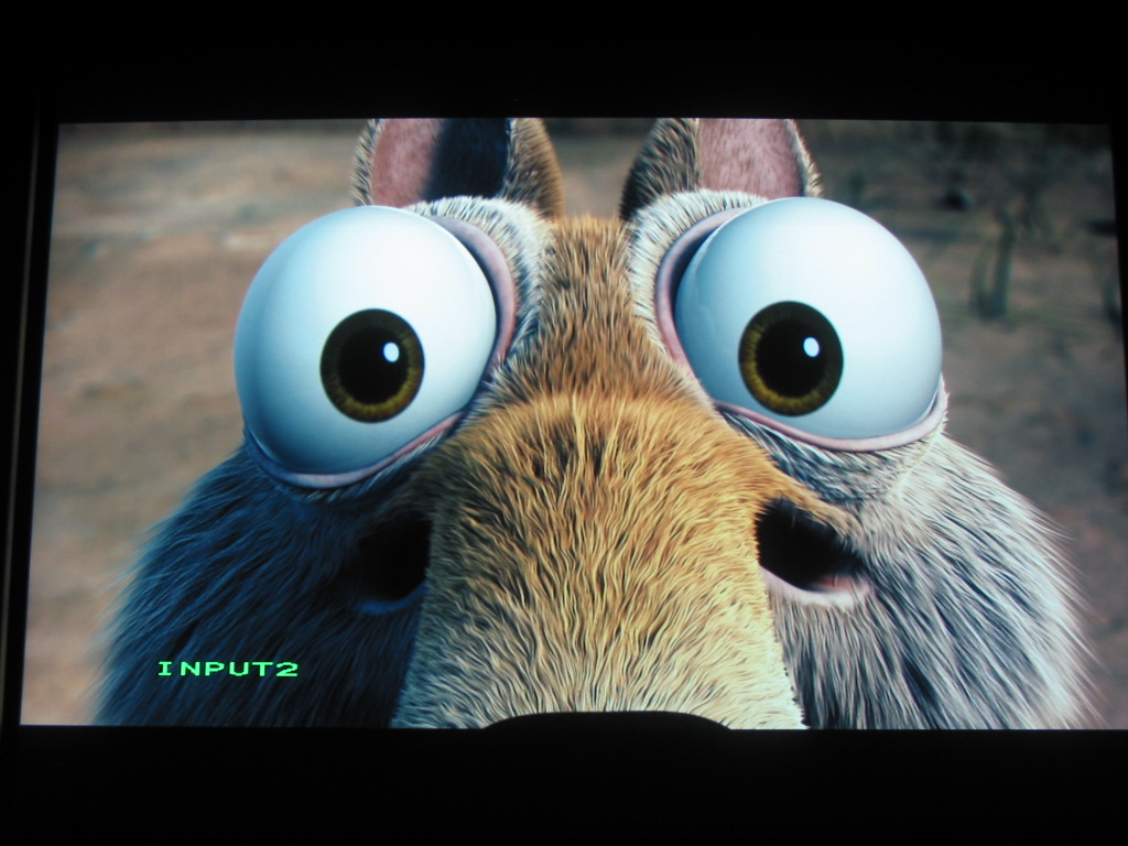

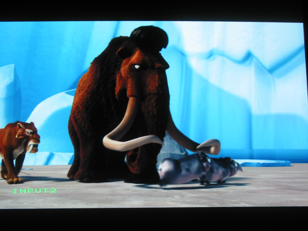

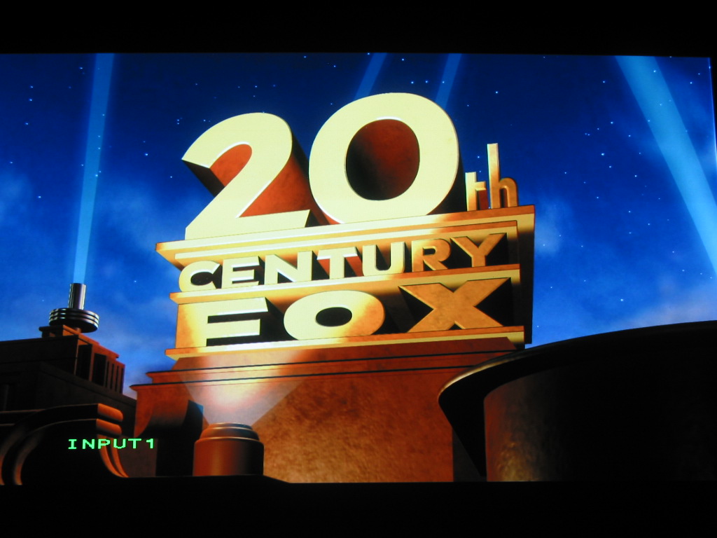

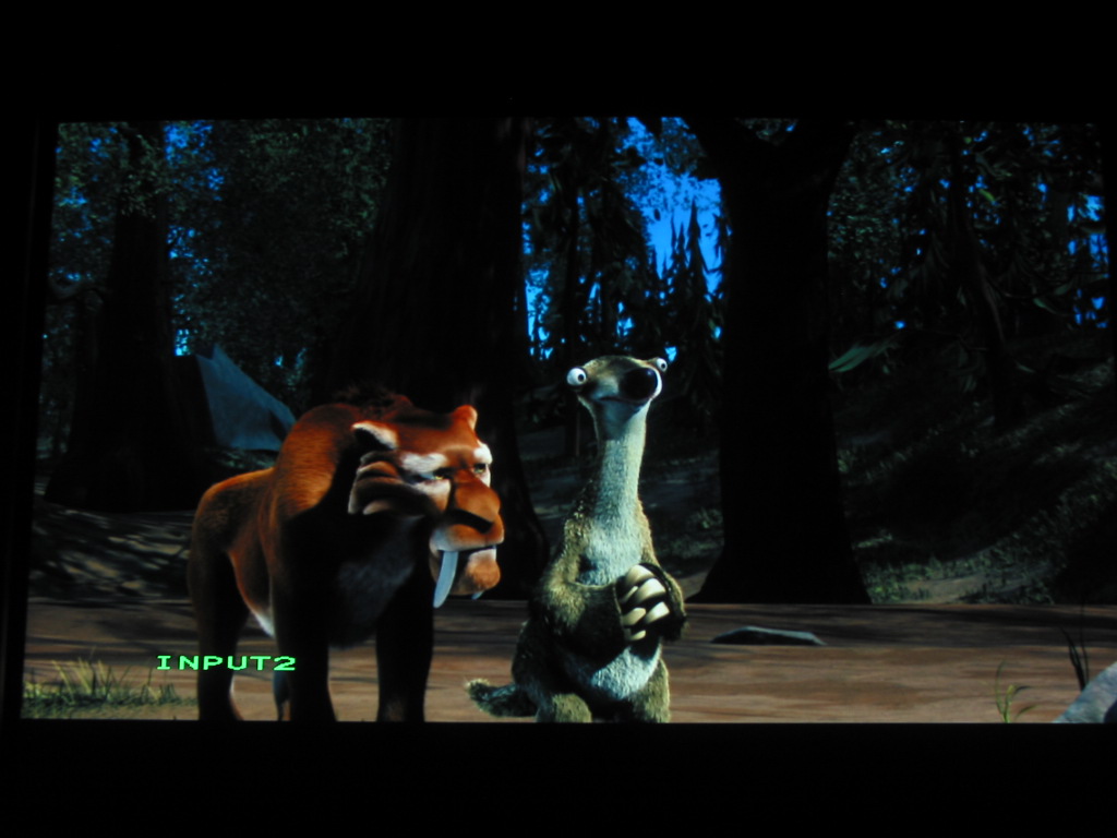

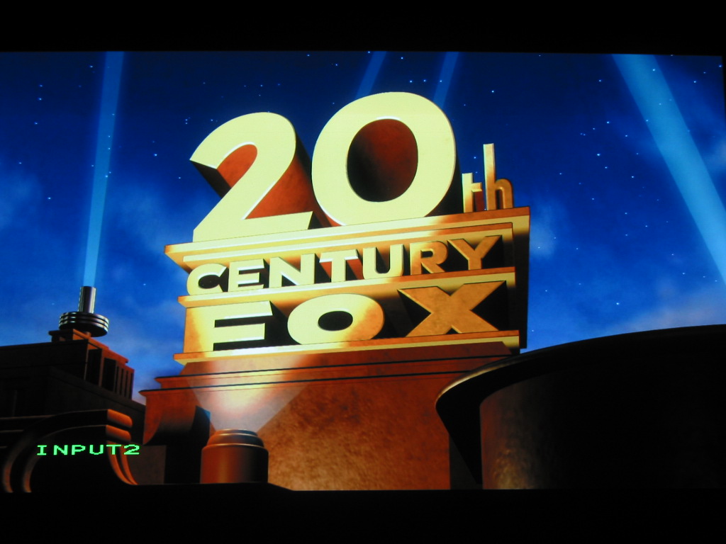

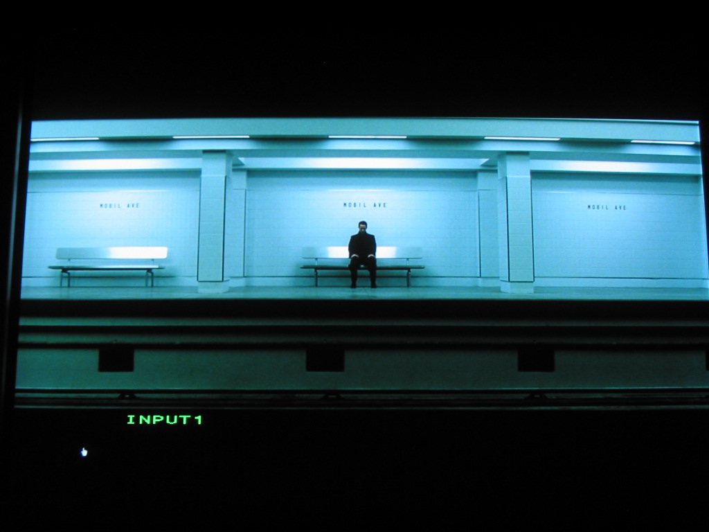

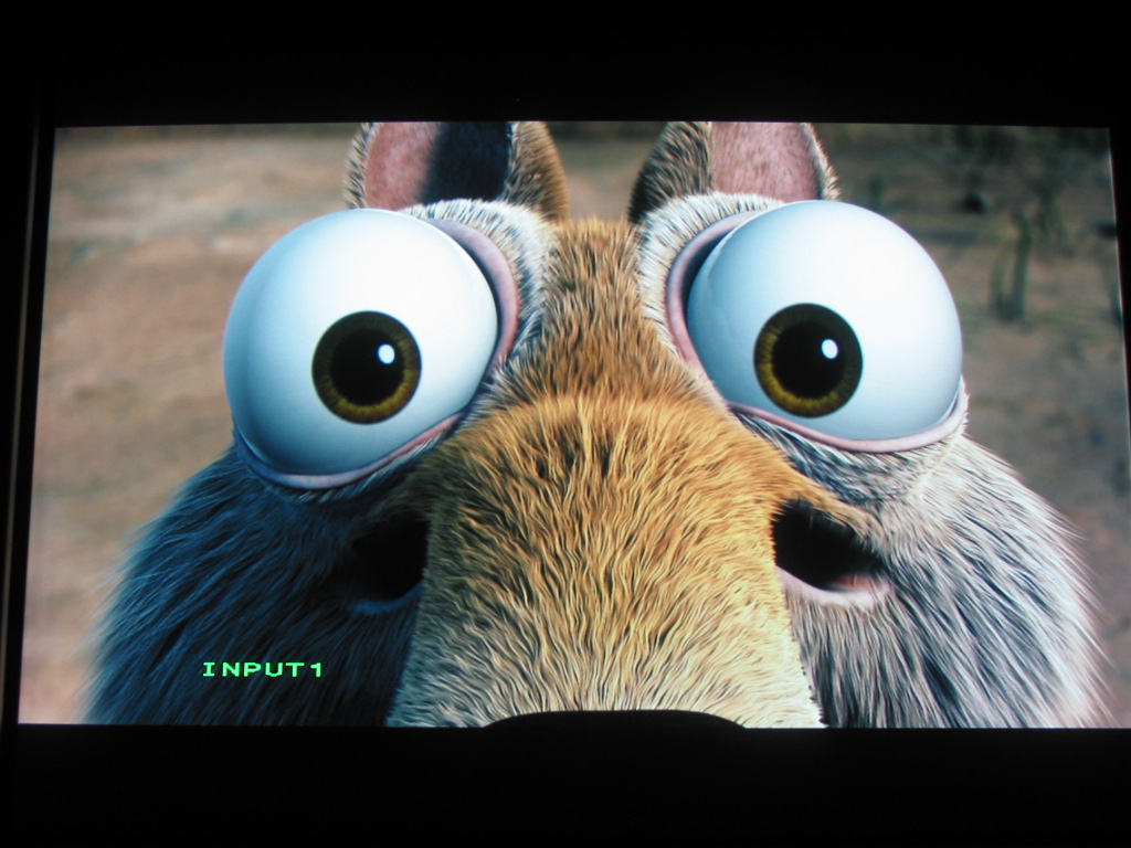

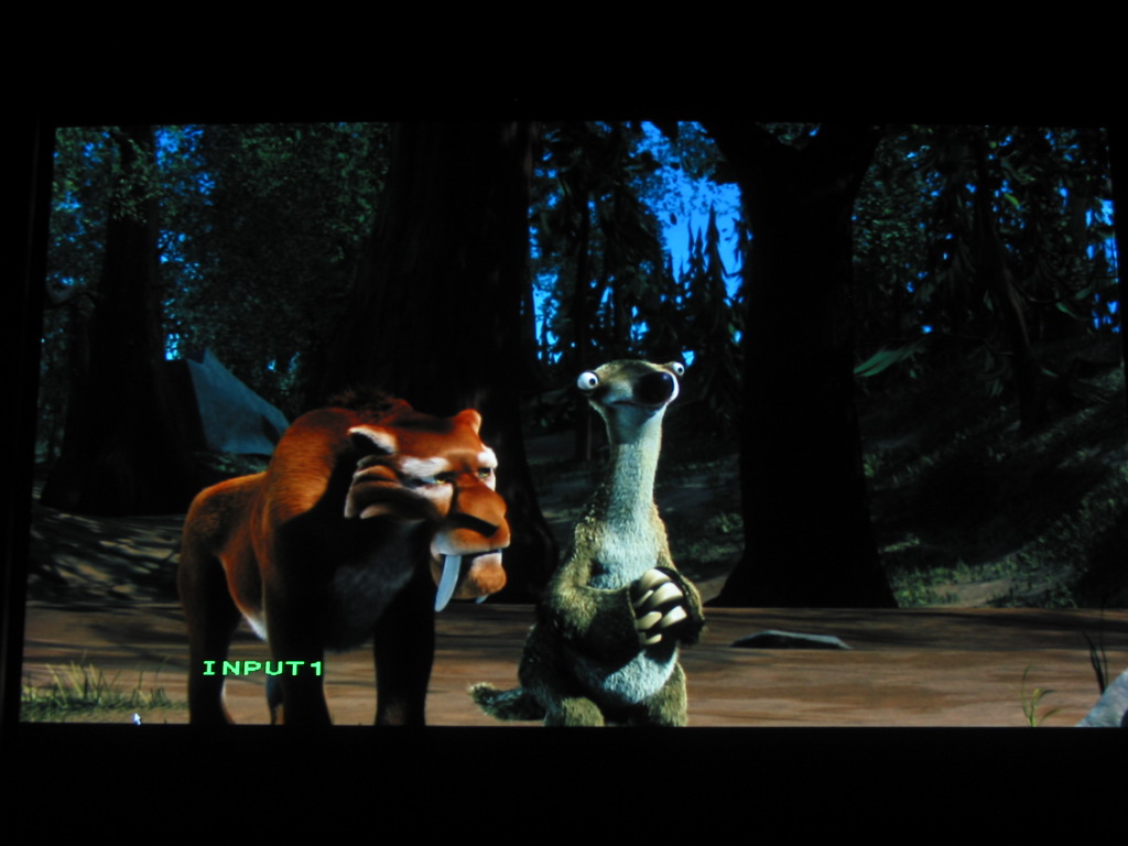

Now in Cliffy style here's a few screen shot's. HD-Fury vs. Analog VGA. Connected as described above.
Source Green Machine HTPC ATi 3850.
Input 1 is HD-Fury
Input 2 is VGA

My conclusion:
The HD-Fury is a great product, the colors from the digital link are more vibrant than the analog. I'm just curious about the image stretch and shift. Also the highlights ( white's ) apear to be over blown a little.
EDIT: The overblown whites are not an issue. It was a video card driver adjustment fix.
I also tried the DVI to HDMI adaptor, which, is generally not recommended for use with the HD-Fury. It was fine at 1080P/60 with the power cord plugged into the 'fury.
I love the fact that I just updated my 2002 CRT monitor to be HDCP compliant. Thumbs Up

So I also had the Moome cards loaded and ready to go. I bought a HDMI to DVI-D cable, a DVI-D to DVI-D cable, and had everything setup with a RGBHV break out cable from the switcher to the G520P monitor.

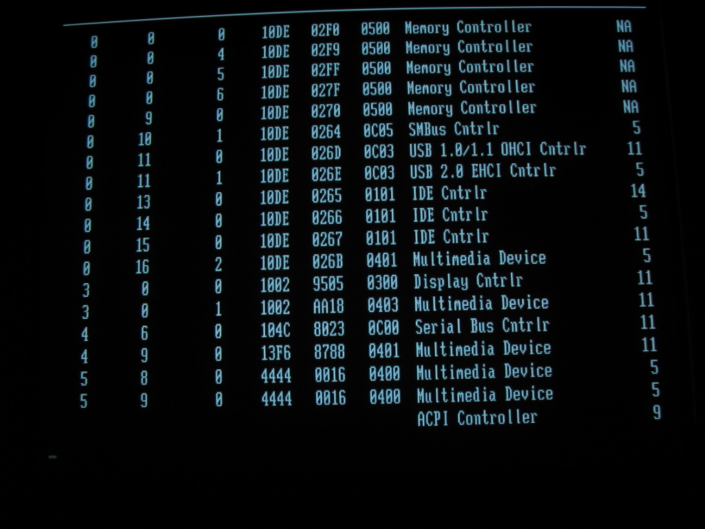

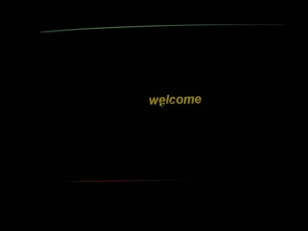

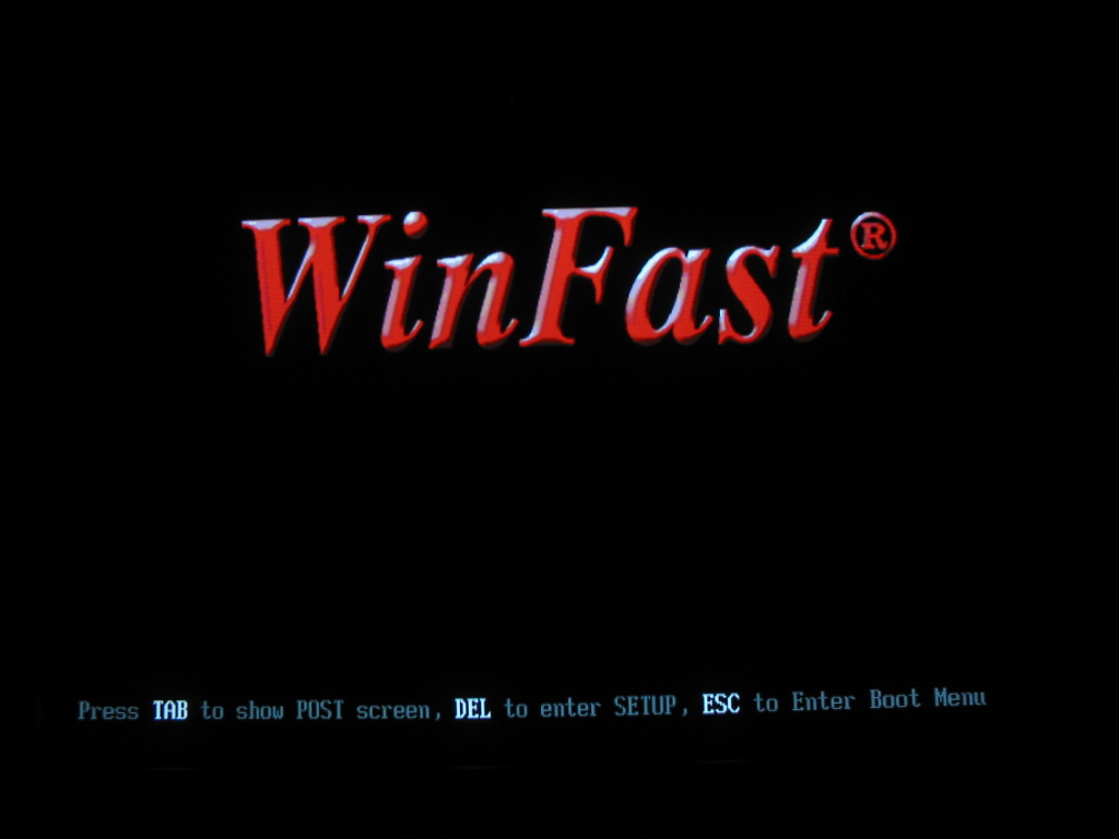

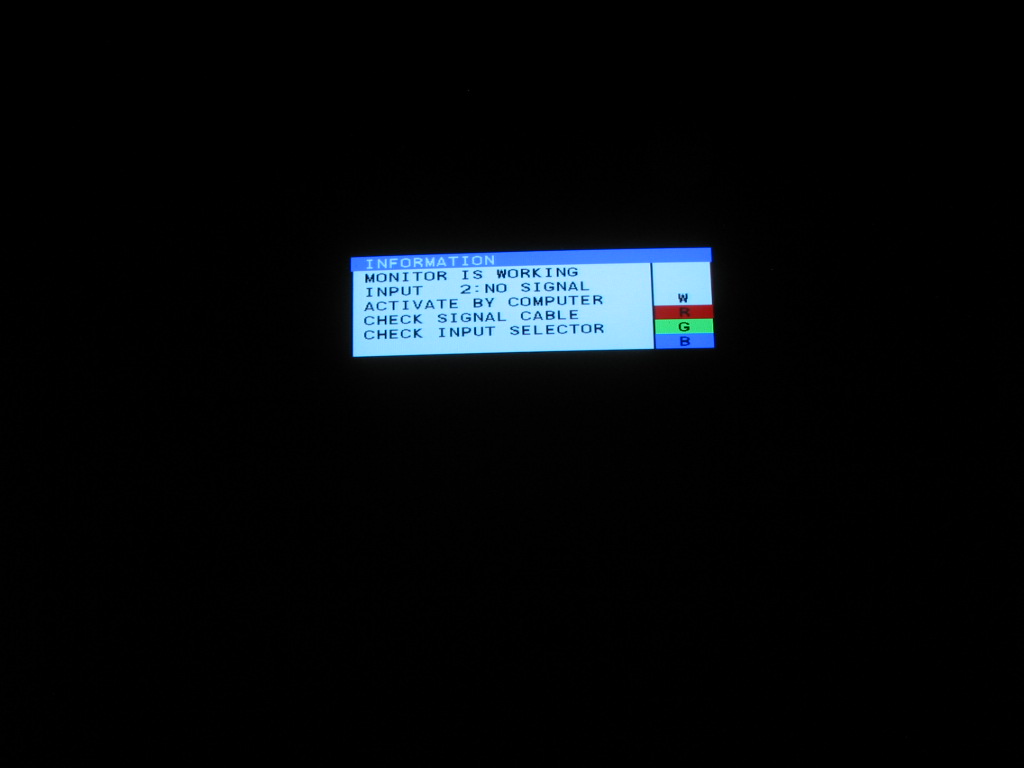

Now here's where I got baffeled....this is the screen shot I got from either of the Moome cards:
 Filesize:  72 KB
 Viewed:  16254 Time(s)
 Filesize:  119.36 KB
 Filesize:  179.31 KB
 Filesize:  44.08 KB
 Filesize:  53.85 KB
