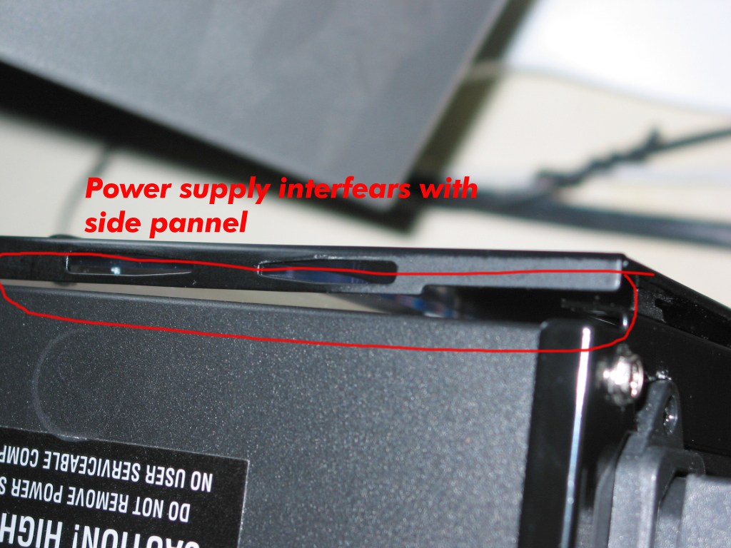

Nope won't work on the power supply side. There's not enough room. I had to remove some rivits to make the side panel fit. Then there was velcro.
Posted: Wed Feb 07, 2007 11:44 pm    Post subject:
I'm thinking I should replace the freshly painted plastic rivits with some allen head bolts and nuts. These are the ones that hold the plastic side panels in.
Trip to Brafasco next week see what I can come up with.

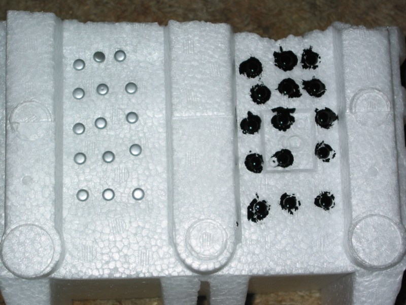

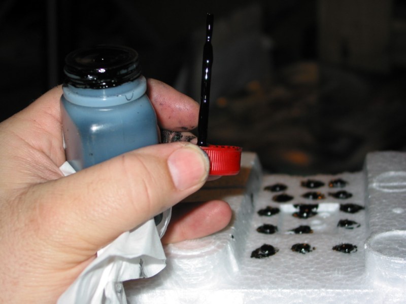

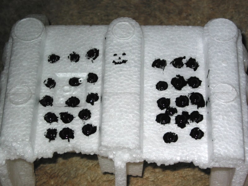

So I painted the plastic rivits like this:
A little touch up paint from my Chevy
 Filesize:  60.84 KB
 Viewed:  9791 Time(s)
Before and after shot

Done! :)
 Filesize:  103.31 KB

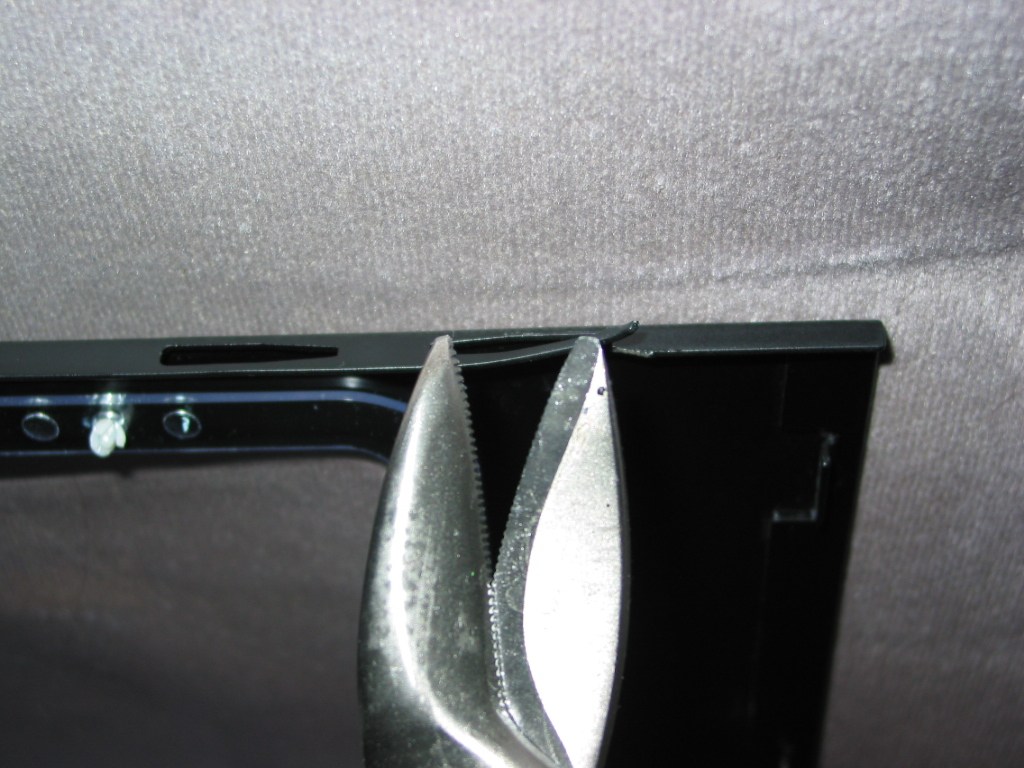

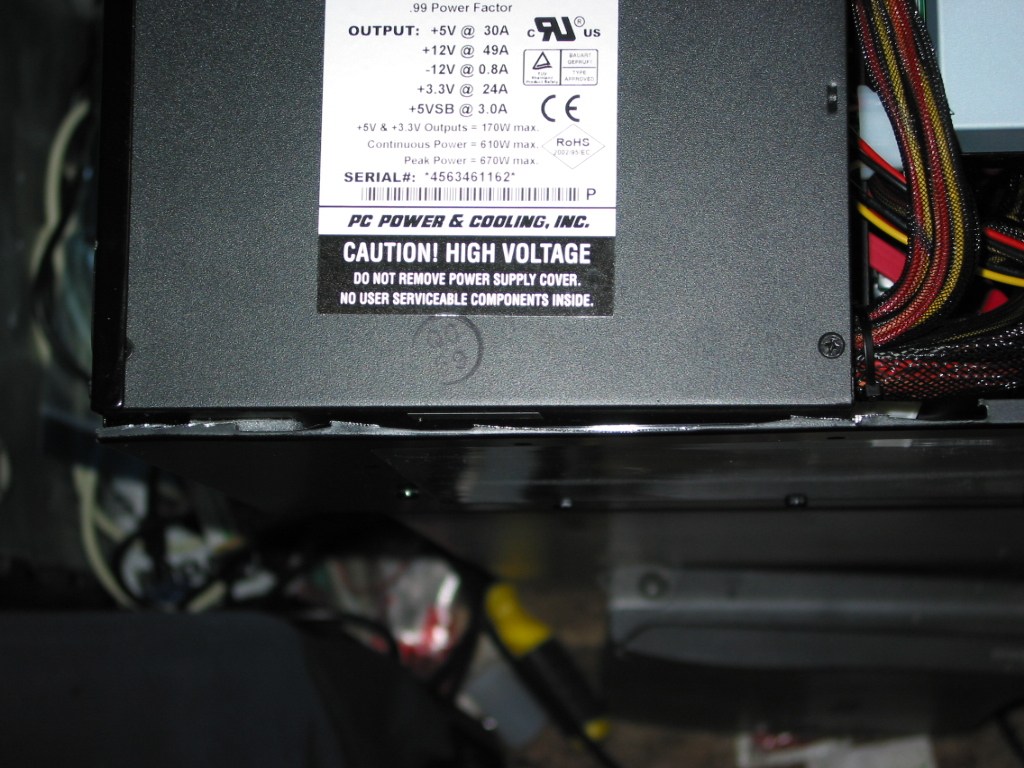

The pannels didn't fit right after assembly so I fixed them:
Doesn't quite fit.
 Filesize:  141.81 KB
 Viewed:  9755 Time(s)

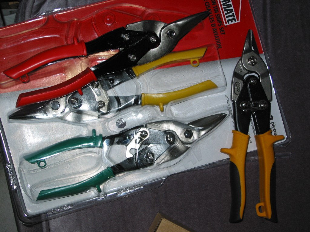

Some new tools
 Filesize:  172.21 KB
Little snip
 Filesize:  139.7 KB
Finished
 Filesize:  168.17 KB
 Viewed:  9756 Time(s)

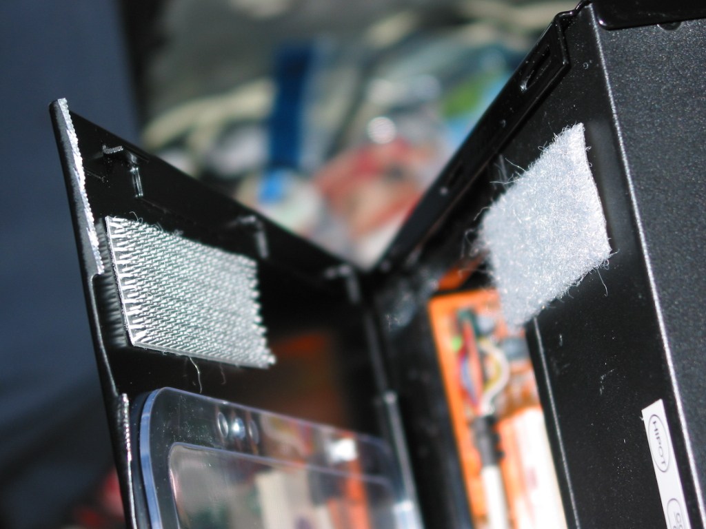

Posted: Thu Feb 08, 2007 12:28 am    Post subject:
And to hold the side pannel on a little industrial velcro. This stuff almost bends the pannel trying to get it off.
Industrial Velcro. Mean holding power.
 Filesize:  126.45 KB
 Viewed:  9754 Time(s)
