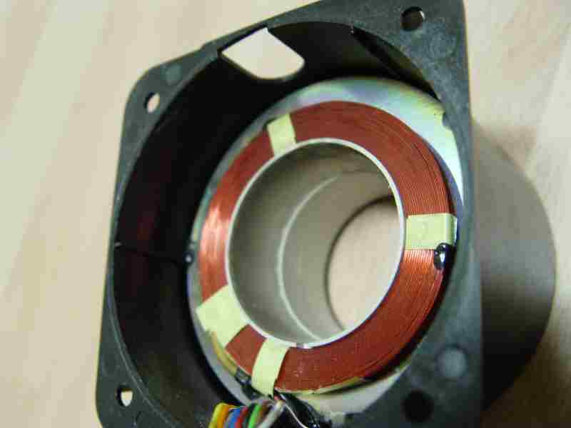

From the broken Blue tube video this is my theory.
The blue tube for some reason either had a bad HV arc or was just ready to break under the focus coil where you could not see a crack, it may have been just small enough to work for that short time while you were displaying the grids. In that time the heat made the crack more weak preparing it for its final dimise.
when you turned the set on after it being off the sudden shock of turn on blew the crack open under the focus coil, then the HV acr from in the tube travled into the focus coil wires to the Focus Board and possibly then arced to the other tubes and to the neck board through the Ground staps. That one bad weak blue killed the whole set, Id right off the FCM,the VNB, the HDM, and all tubes for sure along with their magnetics. To see if my theory is right you'll have to remove the focus coil off the Broken Blue tube open it up and pull out the coil assembly, its glued in. look for burn marks. that is one messed up PJ. First Time ever on a Marquee I bet .

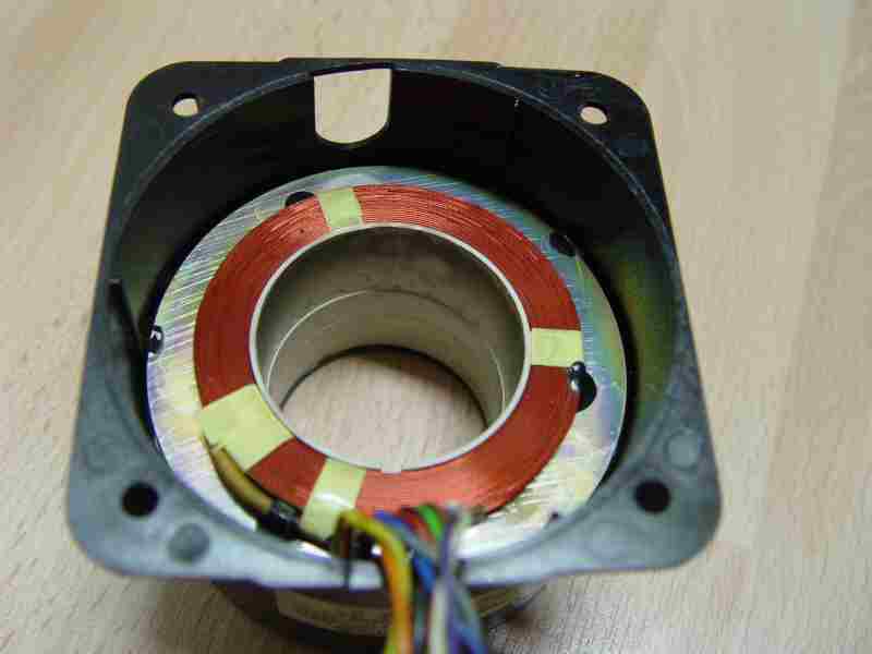

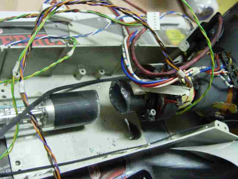

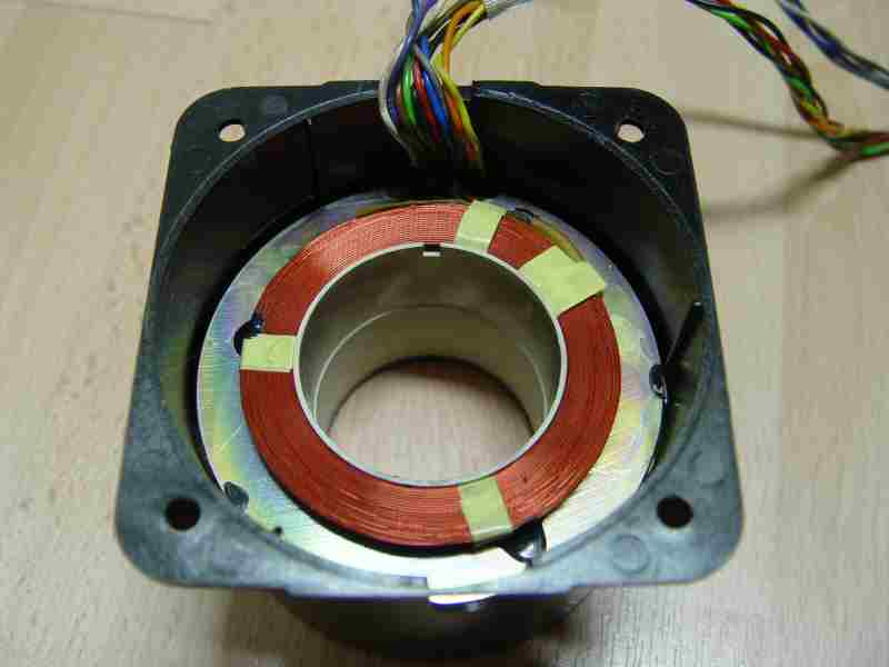

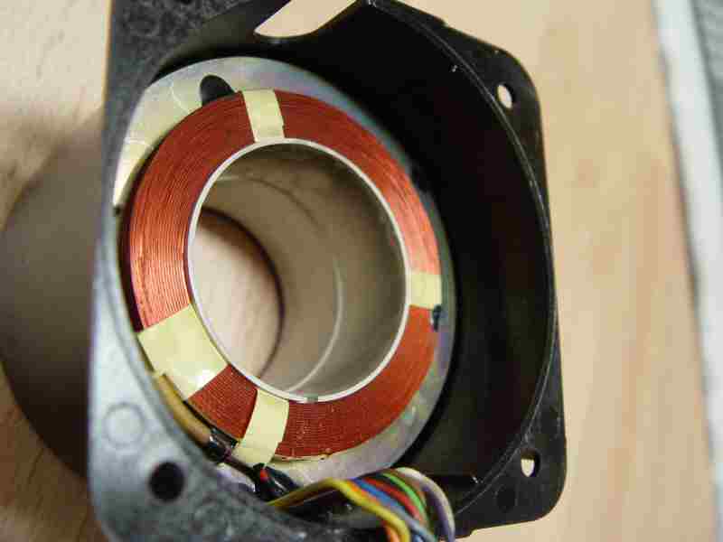

Posted: Sat Jul 26, 2008 9:47 pm    Post subject:
Here are some pics for the analog horror stories section Confused

Yepp looks like the tube was weak or a hair line fractur and when it broke it sent a surge through the whole Focus coil and on to other parts. you can see the soot on the inner plastic bobbin. Also the HV lead looks a bit coverd in soot.

All kidding aside, if that were my projector, I'd pull the tube assemblies for the couplings. Remove the top and bottom LC plates and the Vidikron cover. Then I'd find a suitable cliff to push the carcass off from. Then I'd start shopping for a working 8500 with worn tubes to build another 9"LC with. The only interest I'd have in that chassis would be to conduct a post mortem Crying or Very sad
Just the thought of dropping a new set of tubes in that chassis is enough to give me the willies. Shocked

yepp the only way to set it is to tear it down and if you have a schitty set with bad tube lying around start with putting in the boards from the dead machine to find out whats good or not, I bet the FCM is done, no need to even try to fix it .
HVPS and LVPS might still be ok if no back lash happened. I think it just shot the G2 voltages into the tube and through the focus coil tot he rest of the VNB's and FCM. the HDM,CLM might still be ok, the stuff on the back heat sink might be damaged as the Astig amp is on that and those cables connect to it so the runaway power surge may have gone through the Astig cables too.
that really sucks. One bad tube. But I wonder how it cracked or got the possible hairline fracture if my theory is correct.
Maybe it was a too tight a clamp from the focus coil?
