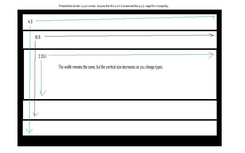

Posted: Sun Jul 20, 2008 11:55 pm    Post subject:
Maintenance cost is up in the air. Keep in mind most of these machines are getting old (especially the entry level ones). If you buy from a dealer like Curt there is some warranty and lots of tech support. If you buy from e-bay or from a paper, who knows.
Digitals need a $300-500 bulb every 1-2000 hours, not to mention color wheels and such breaking down. CRT tubes vary in price but last about 5-10 times longer.
As far as your 2.35 to one question, hopefully this makes more sense. Lord of the Rings is a good example. You will still see all of the film, but the vertical height is lessened to show hte whole image. It's not too bad. See the Primer regarding tube wear. If you watch a ton of 2.35:1 material then go back to 4:3, you are going to see the burn after a long time since the tube wasn't being used at the top and bottom.
