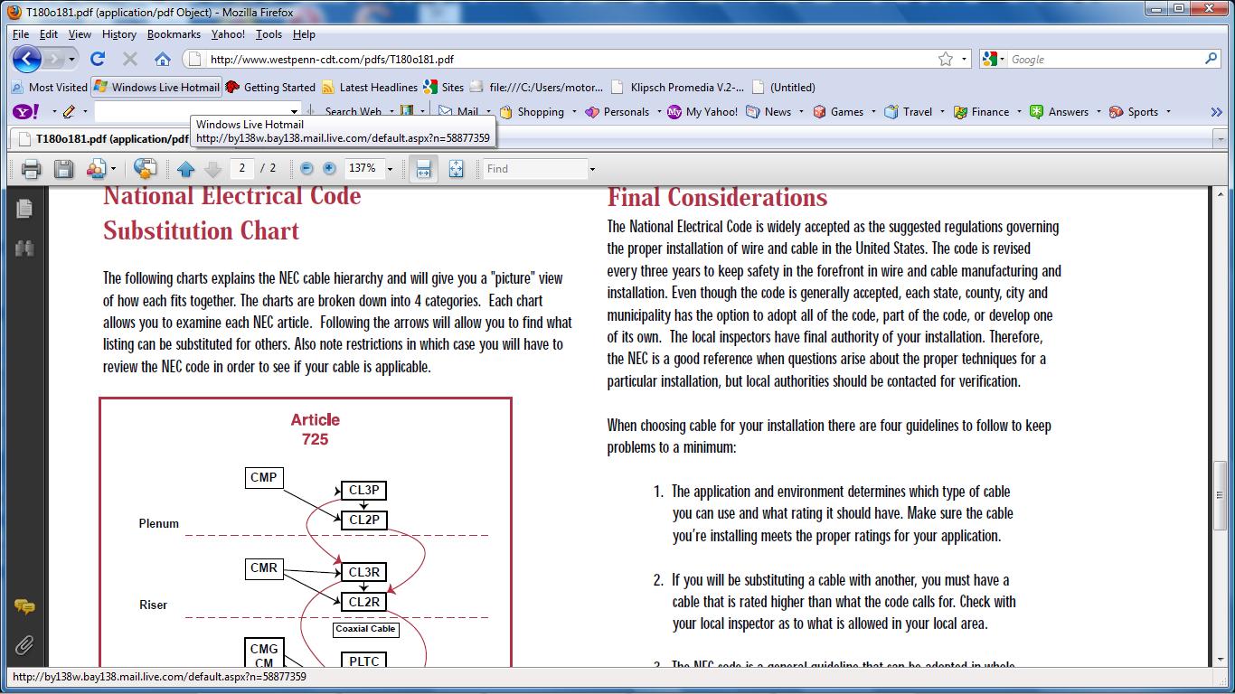

Posted: Fri Jan 22, 2010 3:52 am    Post subject:
Boilermaker wrote:
In every state, the state's Fire Marshall is the final authority for the ENTIRE state.
Unless you have a document that says otherwise, this one says the local authority in the final authority which is what I have always read.
