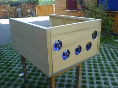

Posted: Thu Jul 10, 2008 6:09 pm    Post subject:
some more pics
 Filesize:  20.96 KB
 Viewed:  8153 Time(s)
 Filesize:  12.8 KB
 Viewed:  8155 Time(s)

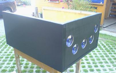

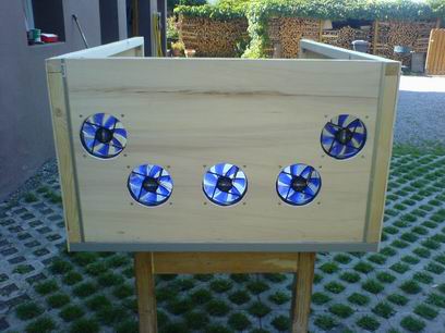

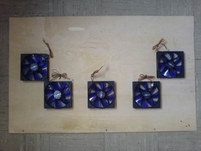

Posted: Fri Jul 11, 2008 3:45 pm    Post subject:
some more shots of the box....
 Filesize:  18.79 KB
 Viewed:  8108 Time(s)
 Filesize:  33.13 KB
 Filesize:  32.48 KB
Barco Cine 9 the one and only
Posted: Fri Jul 11, 2008 4:10 pm    Post subject:
Make sure you decouple those fans from the wooden box or it will act like an amplifier, use some accoustic foam , also maybe line the box with the same foam. You can also get some accoustic liner vinyl to line the entire box and seal edges with green glue. that will make it totally silent. looks nice so far.

Posted: Sat Jul 12, 2008 1:17 pm    Post subject:
Fans are already decoupled Mr. Green
I'm thinkin about using an ATX powers supply with according adapters.
More soon if hardware for that arrives and front is ready........

Posted: Tue Jul 15, 2008 1:33 pm    Post subject:
Hushbox is almost done. Electronic stuff is installed and running. On weekend i can put the 909 in.
Photos soon........
