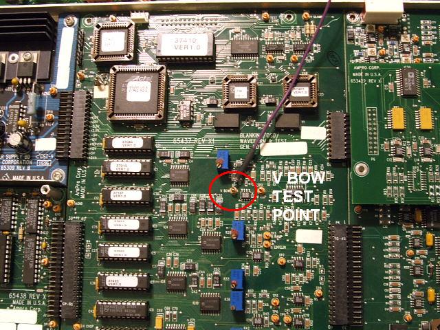

Does anyone with a 3600 or 4600 have a hard-wired jumper between the reg board (81435) and J3 on the focus modulator board? I do not have it on either 3600 I have, but saw it in the service manual. I cannot see any other connections that could take the place of this jumper. I do have registration boards from 3300s that have this jumper, but they are not #81435.

The wire going from the registration bd to the focus modulator (usually a purple one) carries the vertical parabola that is used for top and bottom focus. Does your vertical focus modulation work? I just checked my VDC 3600 and it has the purple wire. I don't think the signal was ever connected in any other way.

What is the connection point on the registration board that the purple wire connects to? Any danger in attaching on to see the effect? Dynamic focus is working, but I'm not all areas in sharp focus at once using static or dynamic controls. I've already done the CPC magnet adjustments and get very good results in the center, but can optimize either center or corners- not both.

The V BOW test point on the center section of the registration bd is the origin of the vertical parabola for the top/bottom focus modulation. The vertical modulation is obvious when working as it has alot of range. Proper amount of modulation is only 20-30% of the total available.
I modified my projector just slightly by connecting a 100 ohm resistor to the test point then connected the wire to it. The factory didn't bother but it is the proper thing to do.
Remember that when adjusting the dynamic focus it only valid in the center of the top/bottom side and the horizontal really only adjusts the half way down the left and right sides. The adjusments aren't corner adjustments.

Non of my projectors have the "purple" wire. On the focus modulator board, "J3" is a 2 prong connector next to R7. The prong closest to R7 is connected to R7. The other prong appears to go no where. I have noticed that I get little control over top/bottom electronic focus. If I were to add the jumper with the 100ohm resistor, would I gain more control over that top/bottom area? If so, what guage wire do you suggest? Thanks,

Hmmm. Just because I don't remember that signal being routed any other way doesn't mean it didn't happen. The vertical modulation should obviously change the top and bottom focus when adjusted min to max. If nothing is happening it might not be connected. I think my 3600 is the latest revision as almost all of the bds are VDC bds and the vpara (V BOW) signal gets to the fm bd via the flying lead from the registration bd.

Well, the 3600 hanging in the garage is my test projector Wink What's the worst that could happen if I took a alligator clipped jumper wire and test it? Laughing

Make sure you connect only to the pin that R7 connects to. The other pin might be ground and that could damage a chip on the registration bd. That's one of the reasons for the 100 ohm resistor on the TP. If the wire gets connected to something bad there is alot less chance for damage.

Stefuel, I attached a jumper to the V-Bow test pt on the reg. board and J3 (focus board) and saw no change in dynamic focus range, but my PJ had a lot of range before I did this. I left the jumper in place since it appears to do no harm.
