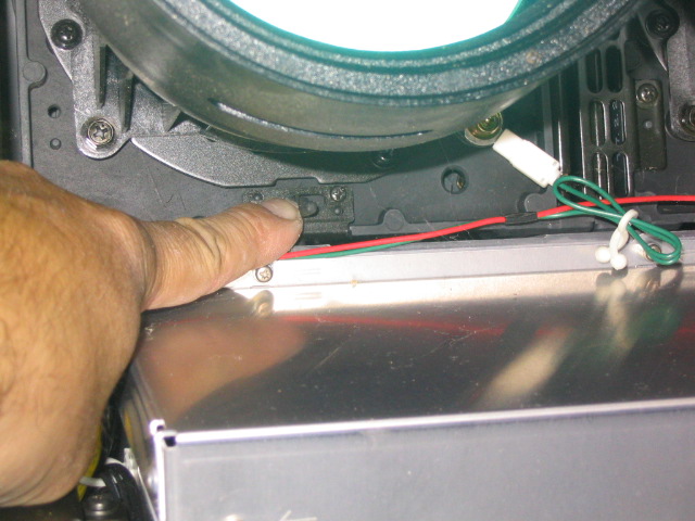

As far as popping the lens off, where's that glycol located again ?
Posted: Mon Jun 02, 2008 9:44 pm    Post subject:
Look at this page:
http://www.curtpalme.com/SonyG70_Layout2.shtm
In this pic, you can see the hex-head burnished Philips lens mounting screws on the lens flanges. Ignore Curt's finger. Wink That's the lens mounting screw.
In the upper-left of the photo, you can also see the black pan-head Philips screw in the metal ring (with a cutout around it in the lens flange). Do NOT loosen any of those screws, or you will break the seal on the C-element and spill glycol.
If you're confused at all, just remember that the screw holding the electrical connector is the lens mount sense wire. If you unscrew that connector, the connector won't be grounded anymore and the projector will know the lens is removed. There are three more identical screws on each lens.
You can also see the mounting screw holes in this pic (at 45, 135, 225, and 315 degrees) :
