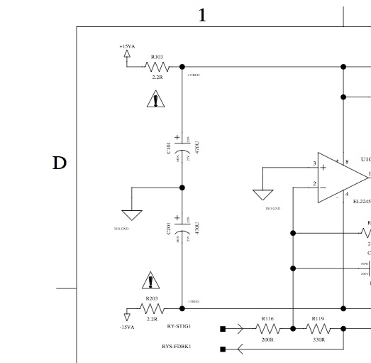

I took out the Stigmator Amplifier Board (the one on the heatsink) for a closer inspection and the moment I got it out, I could see what was wrong (the caps had cast shadows over the offending parts which is why I didn't spot it first time around).
R203 and possibly R103 are blown Shocked Slight damage to the Cap as well, looks superficial but I'll replace it just in case.
Any idea what type of resistors I'll need to replace the blown ones Athanasios? Schematics say its a 2.2R but 2.2R what. (checking elsewhere at the moment - here https://www.curtpalme.com/forum_archived/viewtopic.php@t=2769.html , Jousts Resistor guide ) Red Red, Gold Gold = 2, 2, 0.1, +/-5% OK, so what does that mean? 2.2k ohm 5% but what wattage?

those are 2.2ohm and are a part of the protection circuit, something must have caused them to blow, like maybe connecting the connector backwards?
Many thanks for that Athanasios. 2.2ohm 5% but how can you tell the wattage? Small wattage I guess, 1/2 watt metal fusible?
Something caused it to blow? Well, one of the four leads going into the red tube connector (the white connector that comes from the focus coil) on the Stig board did come out at some point (third one in from the outside edge of the board looking from the rear of the pj). I pushed it back in so likely thats exactly when it happened (can't recall when I did this but certainly in the last 24 hours)!
I am continually surprised at how you can figure these things out - spot on Athanasios, spot on indeed!

If you have the service manual and schematics its not hard Paul, a little common sense too.

The resistors:
http://www.newark.com/97K9580/passives/product.us0?sku=PHOENIX-PASSIVE-COMPONENTS-SFR16S-2R2-5&_requestid=86231
They are 1/2W, but are a special small size, flameproof, with specified overload characteristics. They are used as fuses. If you use some other type be sure to mount elevated off the PCB so it won't burn the board if an overload happens.
There are also 1 and 10 ohm parts in various places used as fuses in the Marquee.
