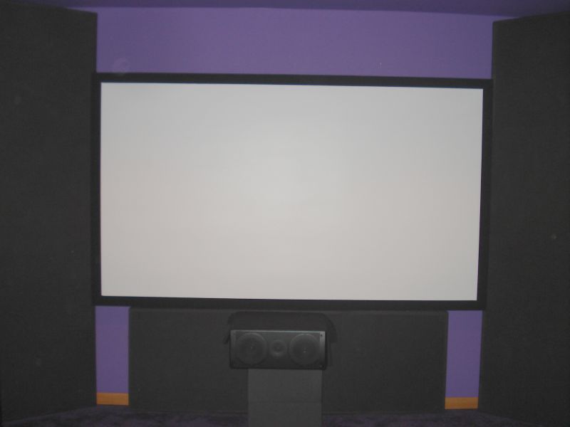

SC, I used Weldwood on the Luan/foam bond, just like I did for the Wilsonart. I didn't have a J-roller but went over it multiple times with a rolling pin with most of my 180lbs of weight leaning on it. (Bent the rolling-pin handles. Smile) I think the Luan just warped a bit on that end and pulled away. I re-glued it last night -- the can says you can re-apply if you don't get it stuck down in time -- and left a 10lb weight on it overnight. It's sticking better now but the Luan is still warping away a bit on that end. Shouldn't be a problem though.
And it's up! If I shine a light down from the top edge, I can see some areas in the lower-left part of the screen where it picked up some ripples from the foamboard -- but I can't see it at all on an all-white screen. No worries.
There is a noticeable "warm" spot in the center, but I doubt I'll see it on anything but an all-white screen. I think the colors may be popping a bit better than they did on the BO, but it's definitely not a night-and-day "oh my God look at that" difference. At least now I know I've got a "GOOD" screen instead of the POS BO I've used for 6 years so I can quit worrying about it. Smile
Total project cost: $80 for the DW, $12 for the foamboard, $12 for the Weldwood, a few dollars for misc screws, dropcloth, etc. Can't knock that. I re-used the Duvetyne-wrapped frame I built last year.
