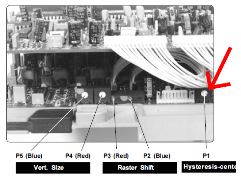

(4) Raster width coils: Turn all 3 all the way in. Adjust the two larger rasters to match the smallest in width at the center point. (Use the horiz R/B shift pots to make it easier to line things up and measure the left to right horizontal centerline). One of the 3 coils must be turned all the way in!
(5) Do a little bit of rough geometry work on green now while viewing a grid pattern: Set up a rectangle on screen that's pretty much the height and width of what you want. Set green raster shift to 49/49. If it's not centered when near 49/49 (midpoint), move the projector! You don't have it installed right! (Some minor offset from 49/49 is ok of course, but it probably shouldn't be more then 10 points away in any direction).
Set your R and B raster shifts to 49/49 (this is the center convergence zone for each tube respectively). Turn on R and B grids one at a time over the green grid and:
-Use the horiz shift pots to line up the R/B rasters to be even with the green (only look at the center of the screen).
- Use vert shift pots to line up R/B perfectly with green (only look at the center of the screen only).
- Use vert size pots to line up the top/bottom of R/B as close as possible with green (only look at the very top/bottom of the screen).
While some R/B raster shift may be used in subsequent steps or over time, your R/B rasters should both remain within a click or two from 49/49 (midpoint).

Haven't ever tested PS3 with crt, but have read that it have too small porch settings for crt. You need scaler to chance porch settings.
Something to test.
1209s have high freq mode for horizontal deflection, that connects two deflection coils to parallel.
->Horizontal flyback time is smaller and this should help with limited horizontal porch settings.
It's adjusted in factory to turn on about 75kHz signal (pot mid position), but it can be adjusted to turn on in 60-90kHz. When it's at 60kHz also 1080p60 is covered.
Check if there is green led on in horizontal deflections daughter board when you have 1080p activated. If it's on you already have high freq mode activated.
If it's not on turn P1 potentiometer (hysterisis center) from vertical deflection board to ccw (I quess), relays should chance mode and led should turn on...

I tried what you said, Led was off, by turning ccw the led came on. Now what?

Adjust Hphase again and see if you get less cropped picture.
Active picture area should be bit wider than in long retrace mode.
