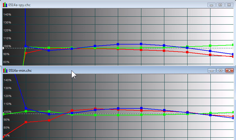

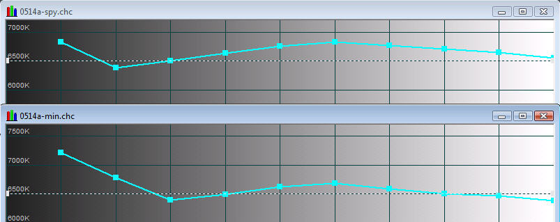

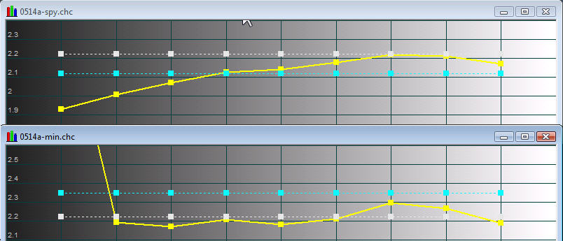

Well this is very interesting. I've always used my SpyderII with the filter OFF, because I was told that was the right way to use it with front projectors. And when I first tested it, that seemed to be true.
But I just dug out the filter and tried it again, comparing it against my Minolta TV2150 colorimeter. I warmed up the projector and both colorimeters for 30 minutes, then ran a grayscale on both of them, both in the same position (about 1' from the screen). I used the 2000 "msec" read time that Kal recommends for the Spyder.
And guess what -- the Spyder looks just fine. If anything it looks better than the Minolta! E.g. the Spyder has more sensible-looking readings at 10-20IRE, which makes sense, since that's below the Minolta's rated range. (Probably below the Spyder's too, but the long exposure probably helps that.) Also, at 100IRE the Spyder shows 10.3 ftL, vs. 6.8 for the Minolta. The lumen calcs above say 7 ftL could be reasonable, but I don't think my screen is THAT dark. An 8500 should be able to throw a lot more than 7 ftL onto an 85" wide screen. I wish I had a known-good standard to compare against...
The pics below show the differences -- Spyder on top, Minolta on bottom. The Spyder doesn't show as much red "hump" as the Minolta -- which makes sense to me, I didn't understand why I'd have a hump in red -- though it indicates I should boost the red Drive a little. The Spyder says my low gamma is a bit low, meaning my luminance is too high there. Guess I should back off on the Moome boost a bit.
So I guess I don't need to throw away my Spyder after all! Smile

You lucked out Gary! My Spyder2 isn't that close to my Eye-One or Minolta CA-100. I also use the Spyder2 with the filter on... I mistakenly told people to take it off in the guide - I've fixed that now.

Well, the fact that the two meters agree very closely (except for ftL levels) is good enough for me. The Minolta is nice for setting grayscale at 30/80% because it reads much faster than the Spyder -- but it doesn't quite agree at 80%. The Spyder is nice for reading the full grayscale since it reads more accurately at low IREs and you don't have to type the numbers in by hand. But it is slooow for setting grayscale.
Since the Spyder (with the filter on) seems to be at least as accurate as the Minolta, I think I'll probably sell the Minolta.
