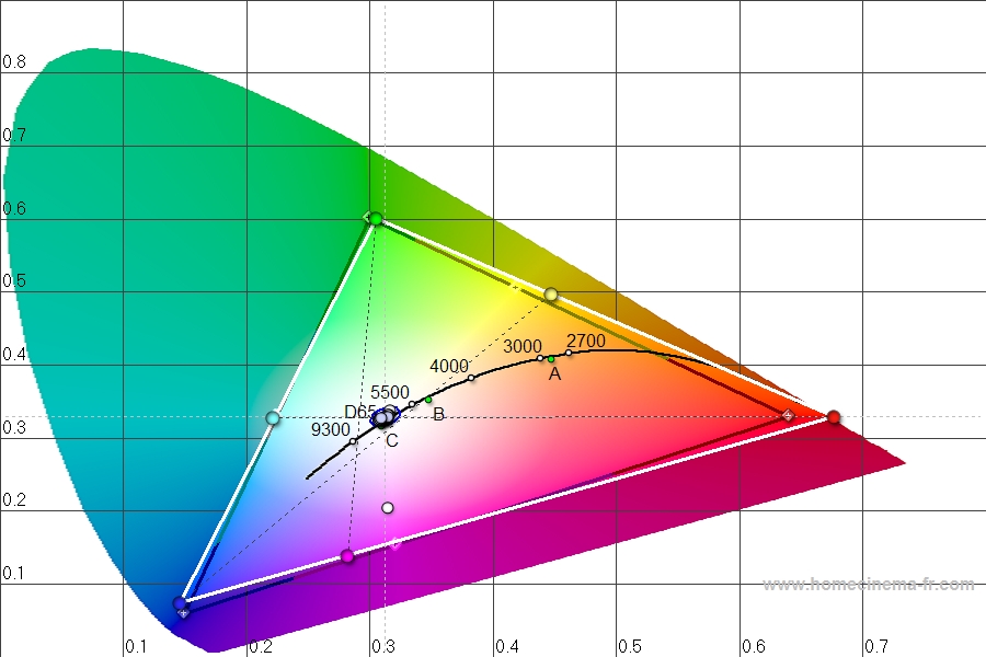

Now I've moved on to color calibration, and unfortunately my Toshiba 50H82 RP CRT doesn't have any CMS controls; not in the user menus and not in the service menus. However, I am using an HTPC for all of my viewing, and was wondering if I could adjust the colors through the ATI video card control panel to achieve a near perfect color calibration. The only problem is I don't understand how to co-relate the video card controls to those described in the guide.
The ATI control panel allows me to control the Gamma, Brightness, and Contrast for each of the primary color channels (RGB). Is the following correlation of these controls to those described in the guide correct?:
Gamma = color 'hue'
Brightness = color 'luminance'
Contrast = color 'saturation'
Thanks in advance.
Gamma = color 'hue'
Maybe someone else knows but unfortunately I do not... I've never used the ATI control panel and actually have very limited experience with CMS's too (none of my displays have complete CMS's).
Gamma = color 'hue'
I tried to play around with my ATI video card color settings and there was nothing I could do to reign my colors in. My color decoder is quite off as in the attachment.
