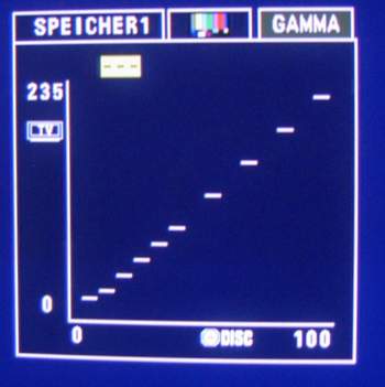

Posted: Thu Jul 10, 2008 9:49 am    Post subject: Gamma - when is best
Hi all.
Firstly a massive thank you to everyone who has contributed to this guide, the HCFR software chaps, recommendations for the Eye-One, the guys over at GetGrey and all at AVS and AV Forums - slowly but surely this calibration stuff is beginning to make sense. Hope I don't begin to test everyones patience and manage to stay on topic.
Had a few calibration attempts on the following equipment following your guide Kal - absolutely excellent - nothing made sense to me before this :
Pioneer 4280
Denon 2900 connected via component - 576p out
Eye-One Display 2
HCFR
I know this is generally a CRT forum so I don't expect specifics about the Pioneer panel.
Sorry about the next bit but just in case not many people have the Denon...............
The Denon has gamma adjustment. The vertical axis runs from 0 - 235 TV (digital RGB I think this is called). The horizontal axis runs 0 - 100 Disc (Wonder if this is IRE steps). There are ten divisions along the 0- 100 Disc line with each of these points adjustable up and down the 0 - 235 scale. The lowest can go to 16 and the highest to 235. The first six of these steps are bunched evenly across roughly 0 - 40 with the remaining 4 steps evenly distributed from 40 - 100. These divisions cannot be changed - only 16 -235 for each point.
I don't quite get the connection between performing greyscale adjustment and gamma adjustment (it's probably in the guide but I get so rammeled up I miss things that are obvious).
Question What sequence would be best to follow - gamma first then greyscale (always changes the gamma) or greyscale first then gamma (seems to always change the greyscale)? Question
Haven't yet mastered submitting charts from HCFR but will practice if this would to understand what I'm asking.
Any comments I will do my upmost to follow and comprehend
Thanks chaps

Posted: Thu Jul 10, 2008 3:31 pm    Post subject: Re: Gamma - when is best
Hi!
I would leave gamma alone for the first pass, get greyscale close to perfect as possible, then adjust gamma and re-measure. It's a very itterative process and both affect each other so it really doesn't matter which you do first since you'll be doing the entire loop through many times.
