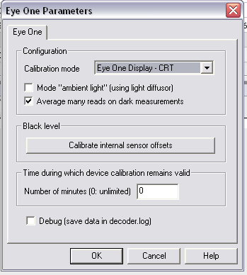

Posted: Mon Jun 23, 2008 7:14 pm    Post subject: Option to "average many reads on dark measurements"
This setting takes longer (about 30 to 40 seconds at 10 IRE, but back to normal at 40 IRE), but results are more consistent at the lower end. Might not want to use it when setting up balance at 30 and 80, but might want to turn it on when running greyscale test.
