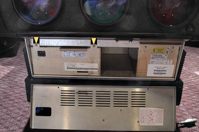

The photo above shows the front panel removed and placed in front of the
projector. The LVPS is the metal box on the left. Remove the two screws holding
the LVPS as indicated by the yellow triangles. You can then pull forward on the

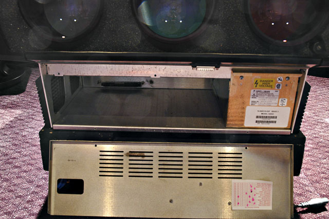

handle located at the top of the LVPS to remove it. Below is a photo with the
LVPS removed:
